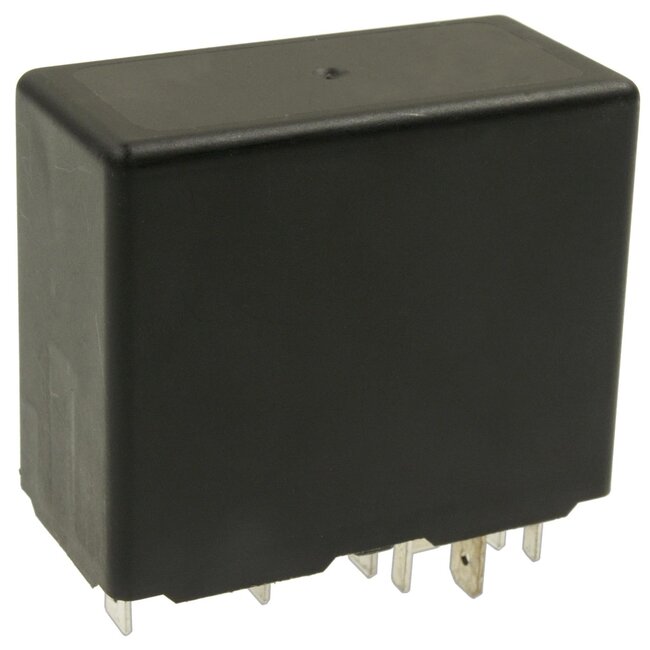

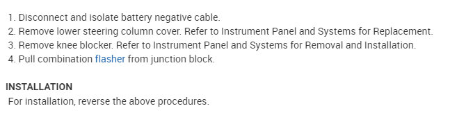

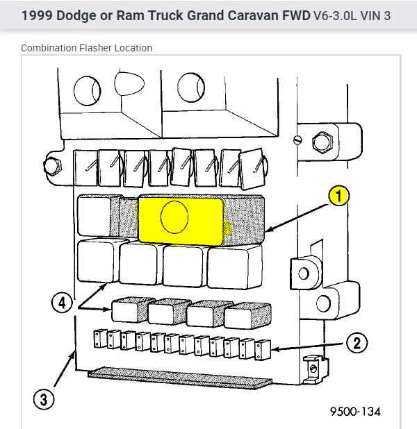

It sounds like the combination flasher is going bad. The idea that it works and then doesn't with a delay in restarting leads me to think it is overheating.
As far as grounds are concerned, they are at different locations. I wouldn't think all would fail at the same time. So, the flasher is my first suspect.
If you look below, I attached the directions for replacing the flasher.
Let me know if this helps.
See pic below.

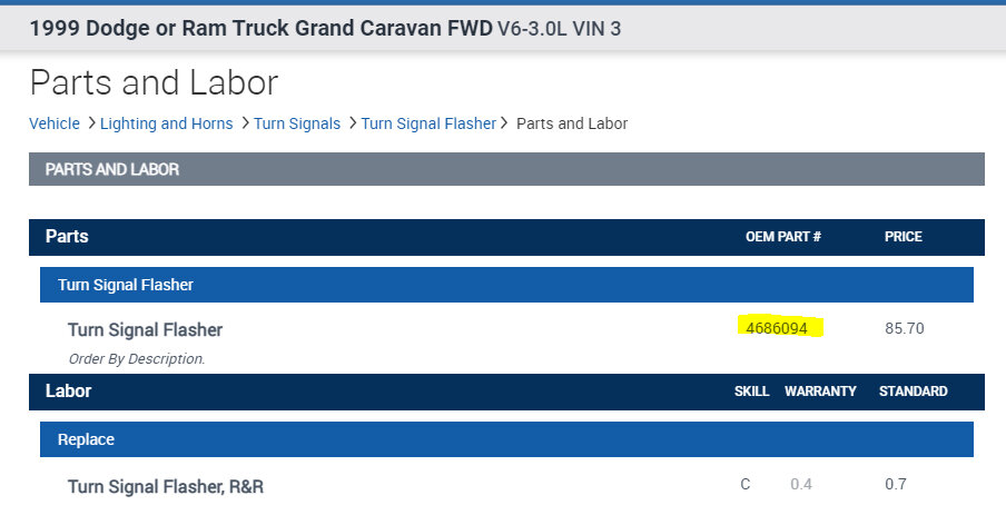

I will definitely give that a shot! I haven't been able to locate a part number for that though, the one's I locate look to be for a bigger relay and parts range from $170-$250 CAD. Any suggestions for a part number?
Dec 4, 2022 at 3:21 AM
  • 110,248 POSTS
Wow! The OEM part is showing much less. If you look below, I attached the parts and labor for the replacement of the unit.
The part number has been highlighted.
Let me know how things turn out for you.
See pic below.

So, the part came today, unfortunately it’s the wrong one. The spot that it looks like it fits into isn’t a single width of relay, it’s a very wide double relay. That being said I ordered a EFL88 which is the direct replacement for that area and hopefully get that soon and can advise then.
When the signals are on, I can feel the “tick” going through that relay so hopefully this fixes it! Otherwise, I’m going to have a hay day pulling at wires.

Hi guys. These symptoms reminded me of finding this problem on three or four of these vans at the dealership. The problem was caused by the excessive weight of the flasher pulling it down out of its socket. Simply pushing it back into place solved the problem temporarily, but the better fix was to tie it in place with a nylon tie strap.
That's my contribution for today.

So Caradiodoc, you've absolutely nailed the solution here; the relay just seems to have excessive weight and a bit of wiggle. When the turn signals go out, I can push that up or down and manipulate it and they will kick back in. I've tried to locate a replacement relay in hopes that it'll simply suffice. This has proven to be a nightmare as most relays only come in as 1/2 of the double wide relay, I'm sure there is probably a way to tear this thing apart and insert the other half but I'm not going to attempt that.
The EFL88 part showed as being the double wide and arrived and wasn't so I think I finally found the right one on Rock Auto; my relay when I took it out lists the part# 4686190 so that's the one I have placed an order for.

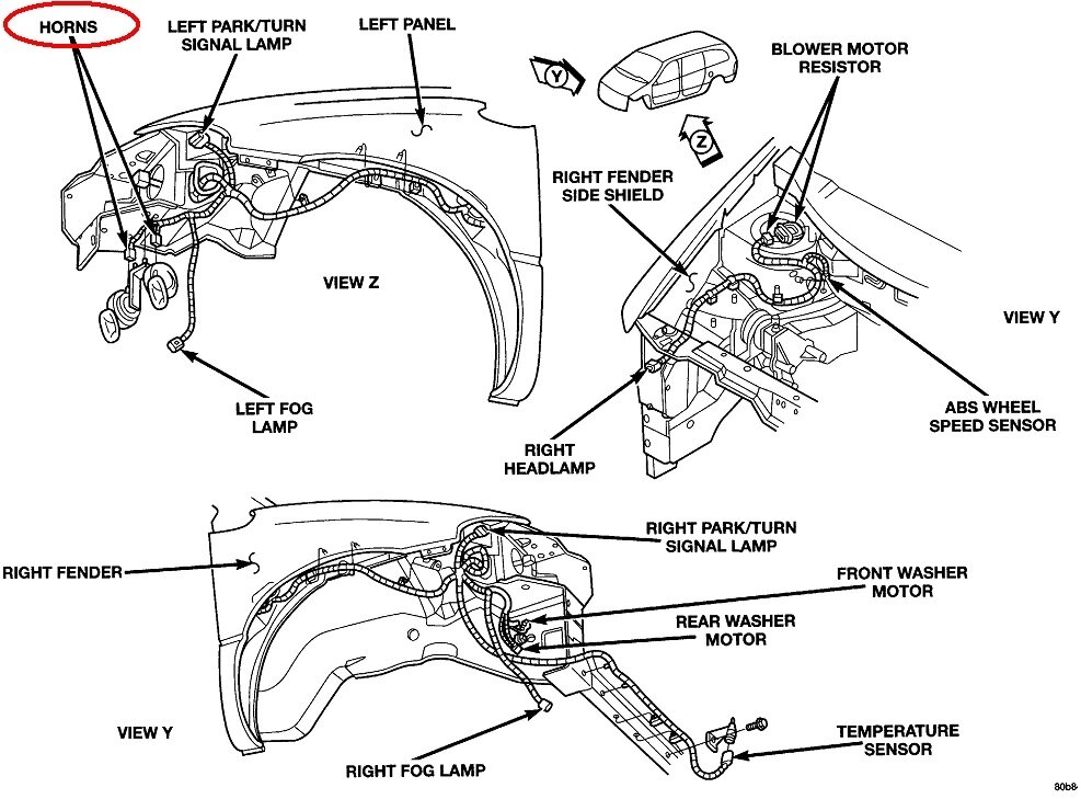

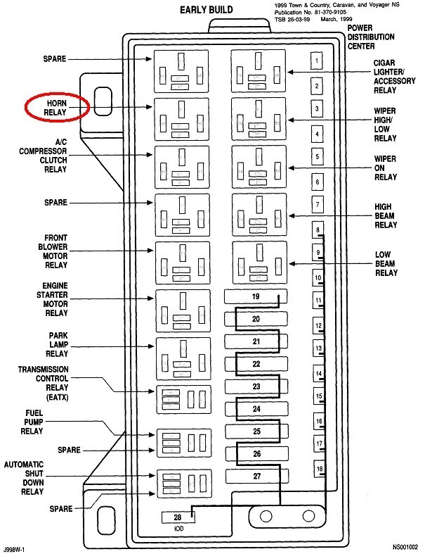

For the horn, grounds are not the issue. A broken ground would stop a circuit from working, but due to insufficient or no current flow. You have an issue of too much current flow.
When you say the fuse blows instantly, do you mean as soon as you plug it in, or when the horn button is pressed? If it doesn't blow until you press the button, a shorted horn is the best suspect. They're under the driver's side headlamp housing. The fastest way to identify this is to unplug both horns, replace the fuse, then verify the horn relay clicks when you press the horn switch. If it does, everything else in that circuit has to be working. Now plug in one horn and try it. If the fuse blows, that's the one that's shorted. There's a "Lo" or a "Hi" molded on it to denote its tone.
If the one horn works, it will sound sick by itself, but you should be able to tell if it's the low or high note. Replacement horns were rather expensive, so the people in my parts department started stocking universal replacement horns for about one third the cost. They came with multiple mounting brackets and hardware. You can also find used horns at a salvage yard, but they did have a pretty high failure rate in the mid '90s. Keep in mind a used one might develop the same problem.
If we need to dig deeper, Joe is going to have you start a new question, and he can help you solve this there. We like to keep the topics in separate questions to make them easier to categorize for others' research. If I see it, I'll wait in case you need more of my wondrous advice.
