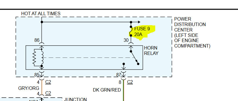

Did these all stop at the same time? If so, I suspect it would be something like a fuse, but the AC and horn /flashers are not on the same circuit.

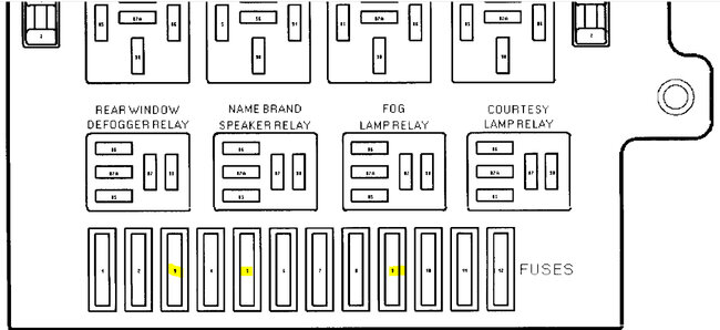

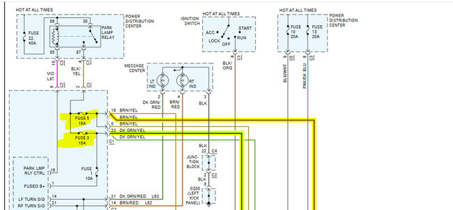

If you haven't already, check the fuses in the power distribution box under the hood. Fuses 3, 5, and 9 are for the turn signals and horn.
If you look at pic 3 below, I highlighted the fuses in the fuse box that need to be checked. Let me know what you find.

Let me know what you find. Also, let me know if the turn signals work at all. In other words, do they light but not flash.
