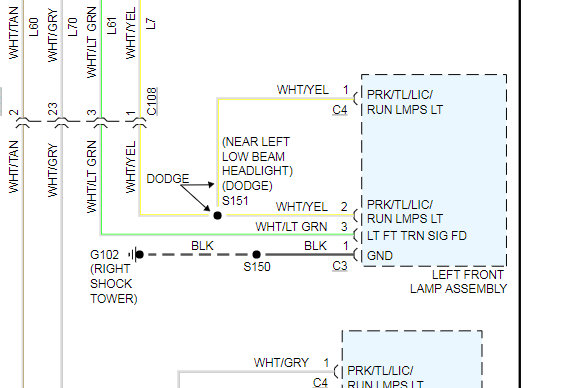

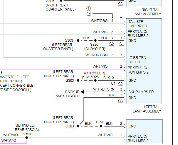

My vehicle's left turn signals aren't working and the left brake light isn't working. All the bulbs are in working condition. When I turn the left signal on, the light on the dash flashes fast like the bulbs are burned out. Also if it matters the vehicles current codes are: P000A,P000B,P0440,P0700.

Issue resolved: Bad ground.
Jan 9, 2020 at 3:34 AM
Well that was fast. Sorry we didn't get back to you to help out but clearly you didn't need much help as you were on top of it. Do you know which ground it was? G303 or G102? Or just tell me what it was bolted to and I will be able to figure it out. That info will surely help others. Thanks
