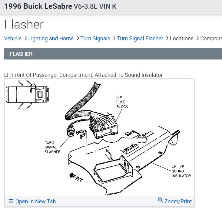

So, my turn signals aren’t working/flashing, but when hazard lights are on both arrows flash. I checked fuse but I can’t tell if it’s burnt.

Yep, this happens when the turn signal flasher goes out. here is the location so you can change it out.
Here is a guide to help you test the fuse:
Check out the images (below). Please let us know if you need anything else to get the problem fixed.
