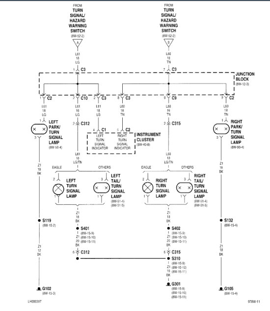

When turn signal or hazards are on the flasher relay makes buzzing noise. Lights work when turned on.
Replaced flasher relay, fuse, and multifunction switch.
Looked over for any obvious grounding or cut wires. Can't find anything.
Any ideas on how to troubleshoot?

Here is a tutorial on how to check your wiring:
I've attached a wiring diagram below.Hope this helps and thanks for using 2CarPros.

Thank you for the diagram that was very helpful. Gives me a better starting point.

Initial troubleshooting shows something going on in or behind the fuse panel. Running out of time and daylight so project for next weekend.
