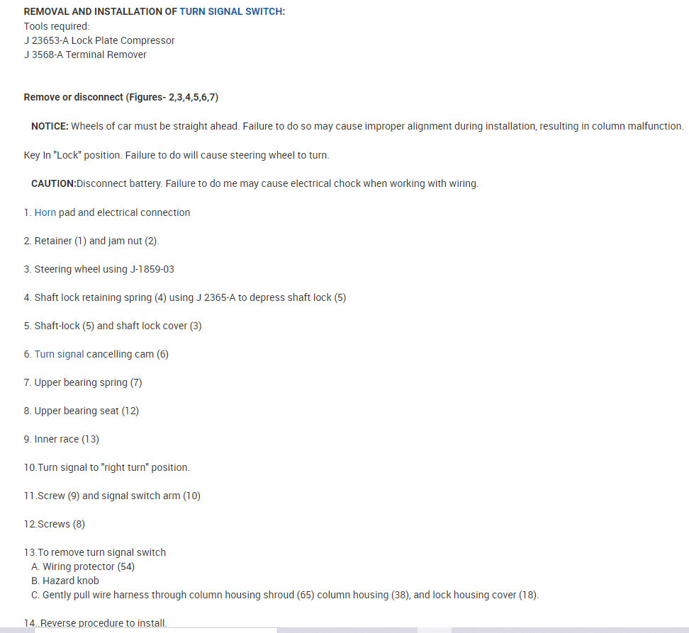

https://www.2carpros.com/articles/turn-signal-switch-replacement
https://www.2carpros.com/articles/turn-signals-not-working-blinker
Can you post a picture of the column so I can see what it looks like to look up wiring and the procedure for the repair?

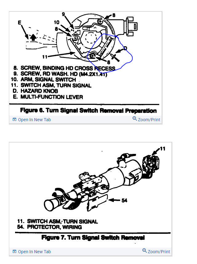

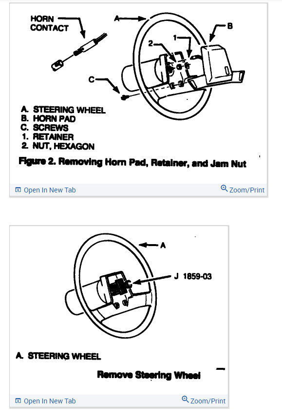

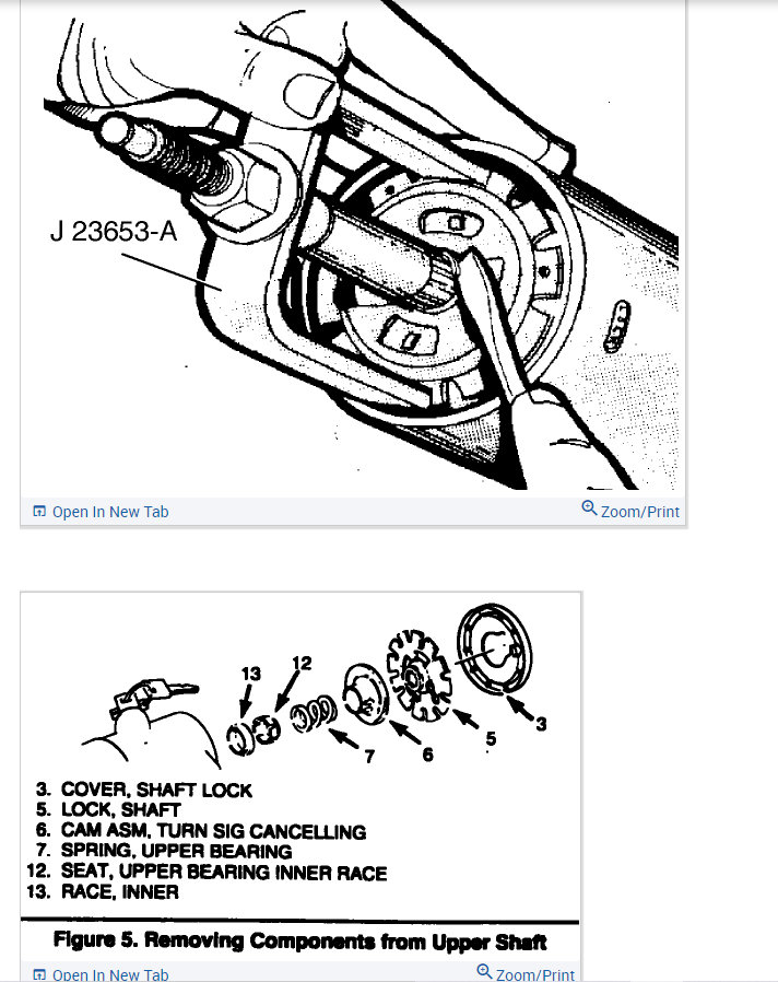

If it is the old style column, the hazard switch is part of the turn signal switch.
I attached the breakdown of the column I was referring to.
