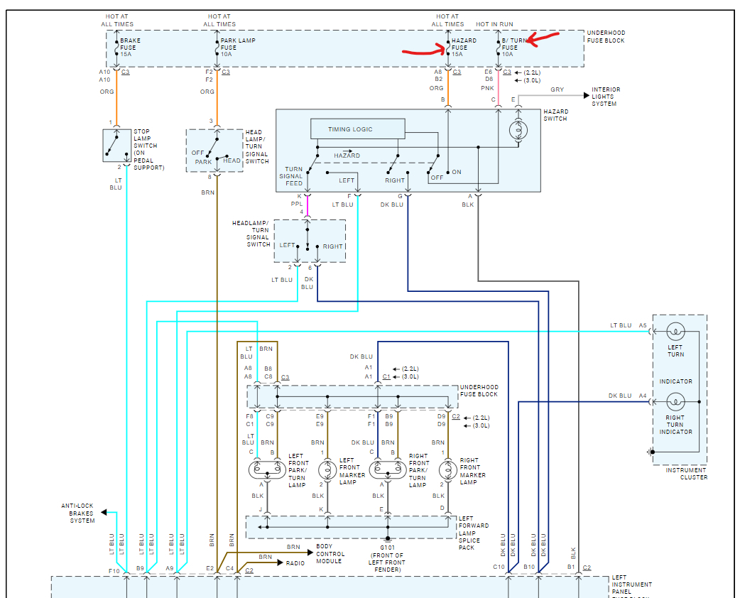

Turn signal and hazard lights not working, where is the relay switch located?
2001 SATURN L200
160,000 MILES • 4 CYL • 2WD • AUTOMATIC
GERALD WATLINGTON
I bought a relay switch but can't find the relay switch location to replace it.
Aug 24, 2024 at 7:32 AM
  • 55,065 POSTS

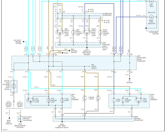

The logic for the hazard and blinker is inside the hazard switch so that will need to be replaced, but there are two fuses I would check first, here is a guide to help and I have included the blinker and hazard wiring diagrams so you can see which fuse (i marked) to check.
