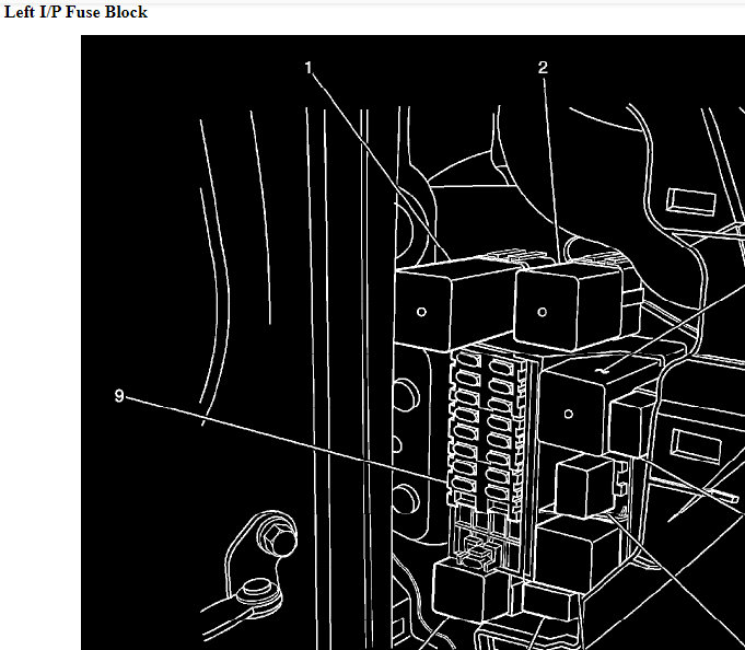

the turn signals and hazard lights do not work at all inside or outside. the switch and the fuses have been changed still nothing. could the flasher be bad it is only $15.00. Where is it located? The turn signals worked intermittently inside and out then just stopped working at all.

On your vehicle the flasher unit is located in the left instrument panel fuse block.
See image below, item 2.
Please let us know how you get along.

Hi Boris, thanks for your reply. This is my daughter's car, it is a sedan, if that makes a fuse block on her car does not look like this at all. The relays on her car are under the hood. i will double check this evening and let you know what i find. i can take a picture of it if that helps.
thanks, John

Hi Boris, i found the flasher relay and replaced it. It fixed the problem. thanks for your help. John
