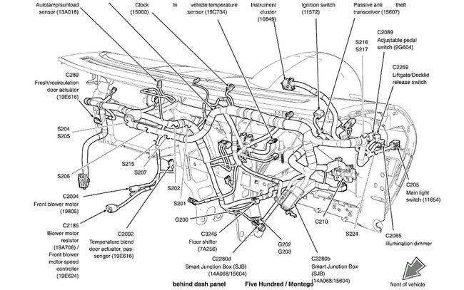

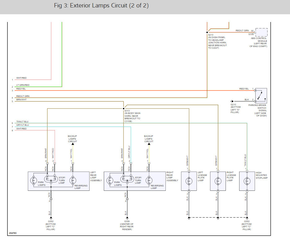

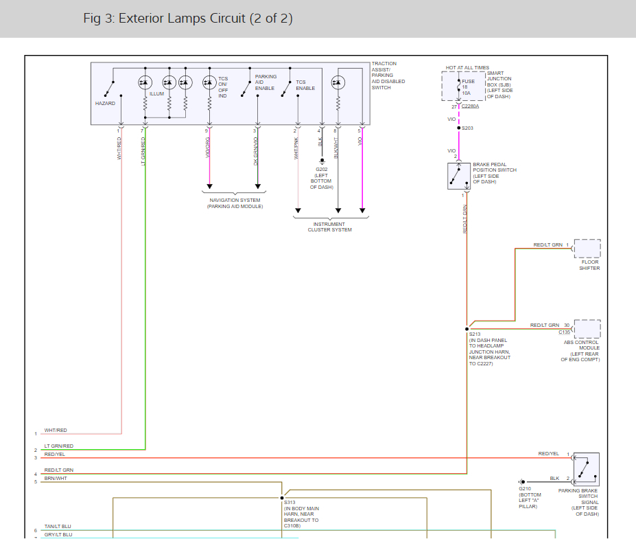

Turn signal/hazards on the right side flashes then stops.
Dec 10, 2019 at 9:44 AM
  • 55,721 POSTS

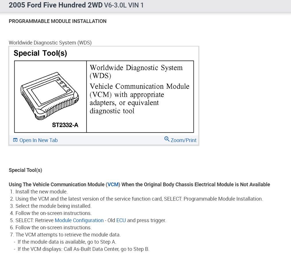

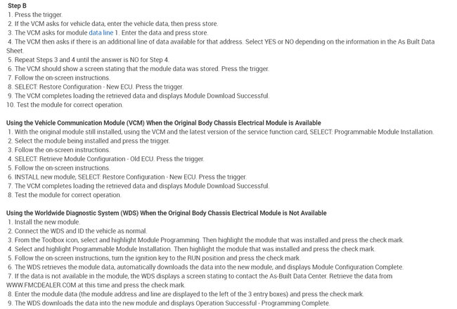

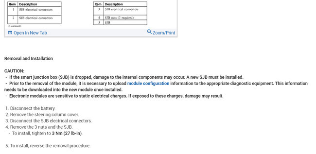

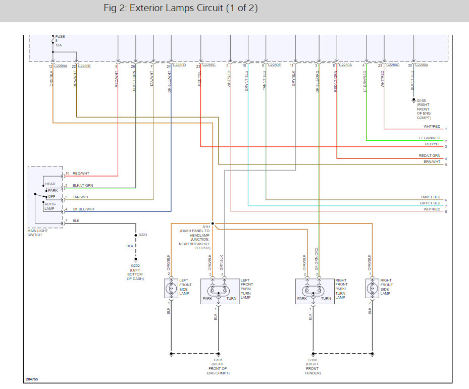

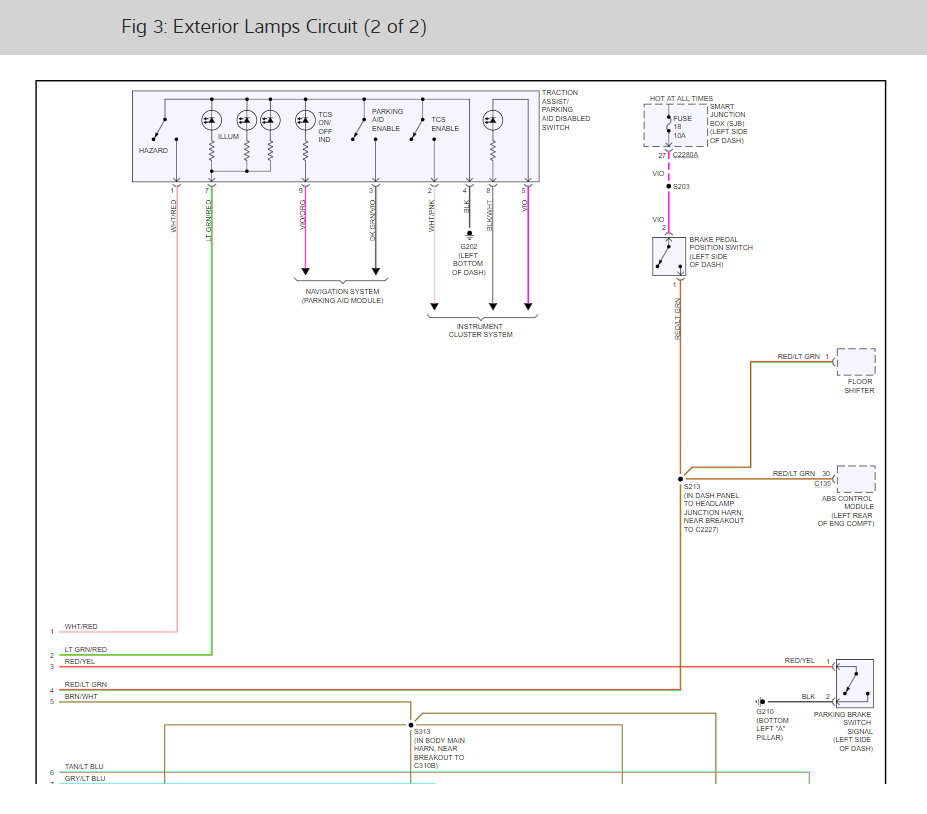

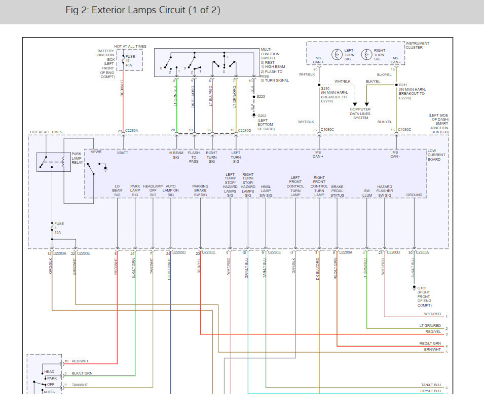

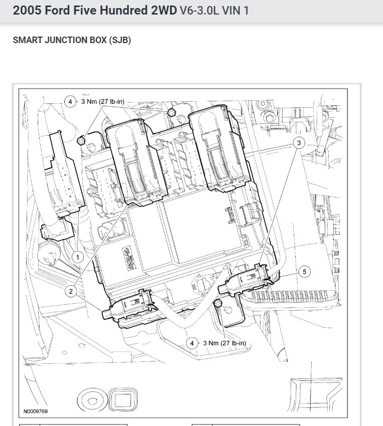

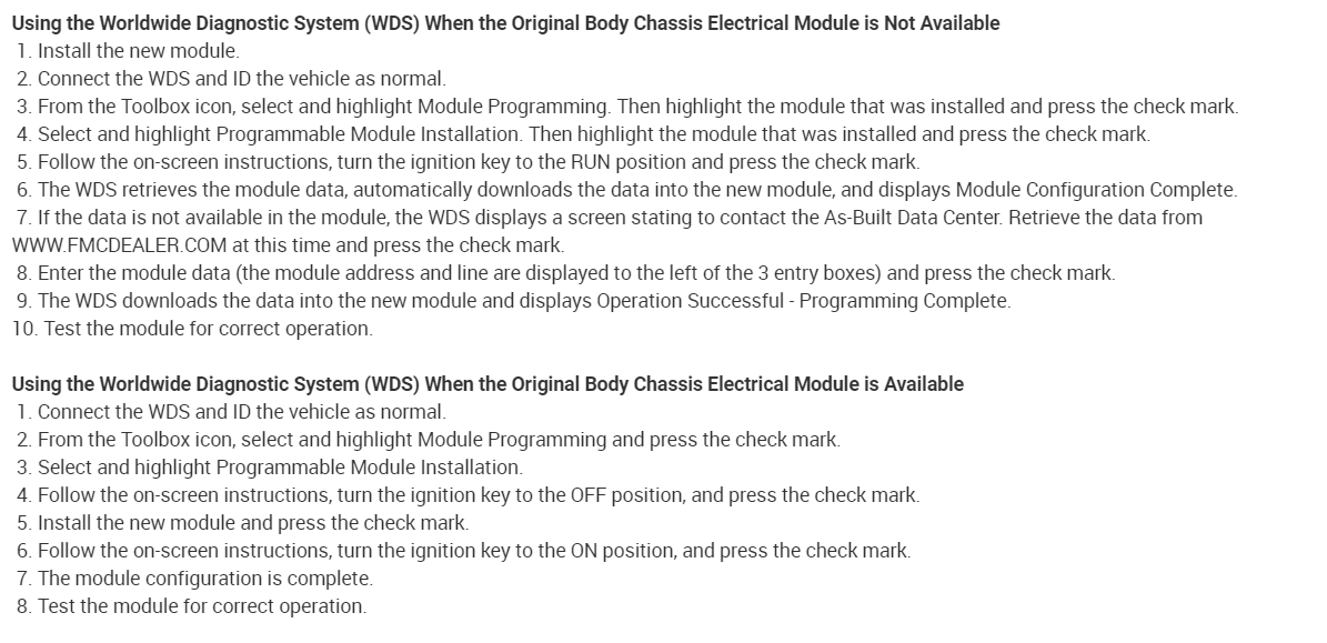

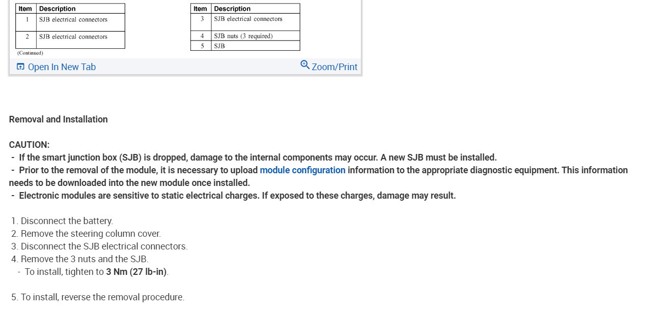

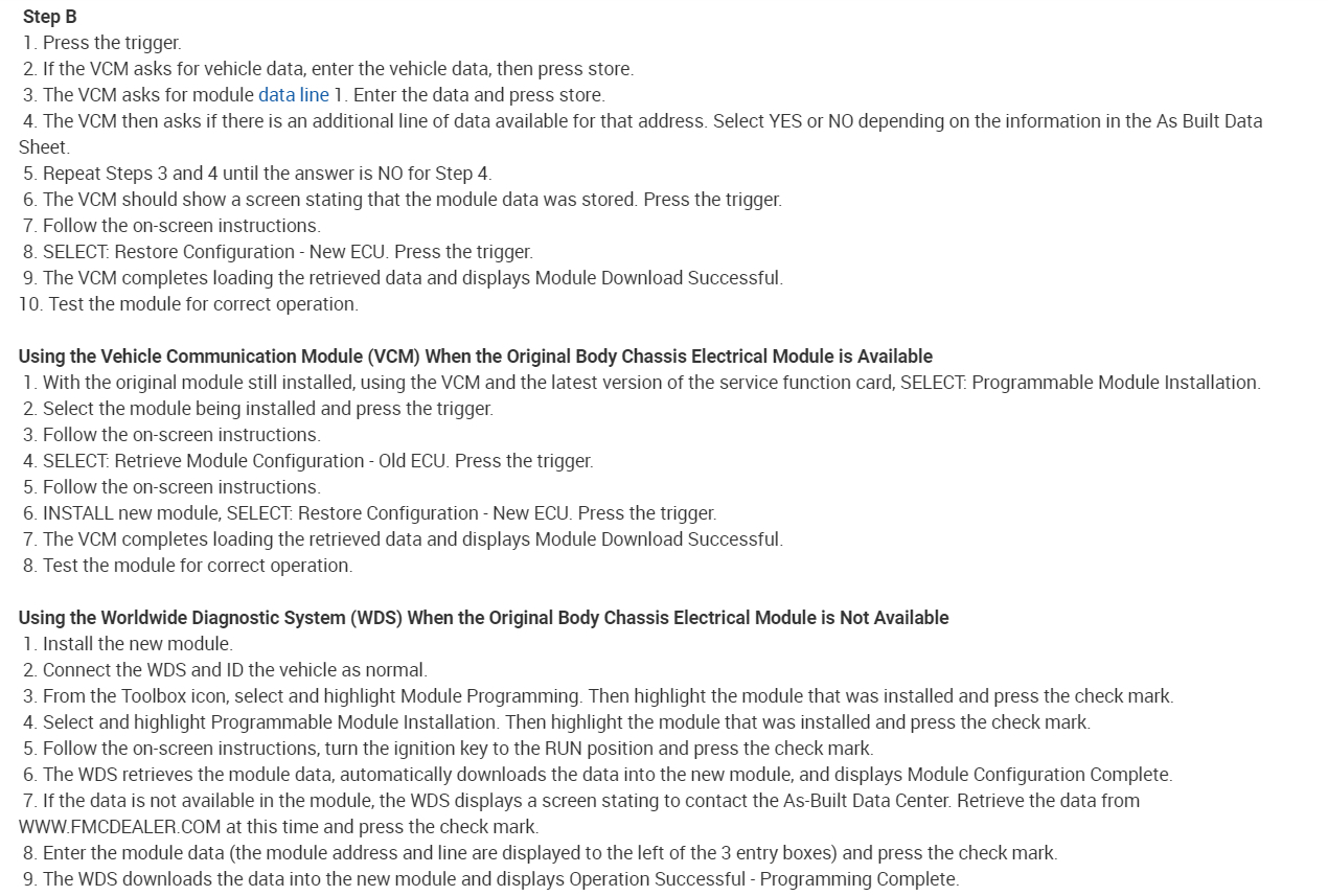

I would replace the bulbs on the right side to see if that helps if not it sounds like the SJB (BCM) is not working correctly and needs to be replaced. here is the location and instructions on how to do so in the diagrams below.
Check out this guide:
https://www.2carpros.com/articles/turn-signals-not-working-blinker
I have found the SJB replacement and wiring diagrams so you can see how the system works. Check out the diagrams (Below). Please let us know what you find. We are interested to see what it is.
