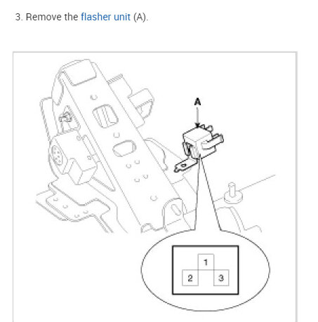

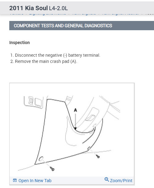

Where is the turn signal flasher relay located?
2011 KIA SOUL
70,000 MILES • 2.0L • 4 CYL • 2WD • AUTOMATIC
JUJU201731
  • 28 POSTS

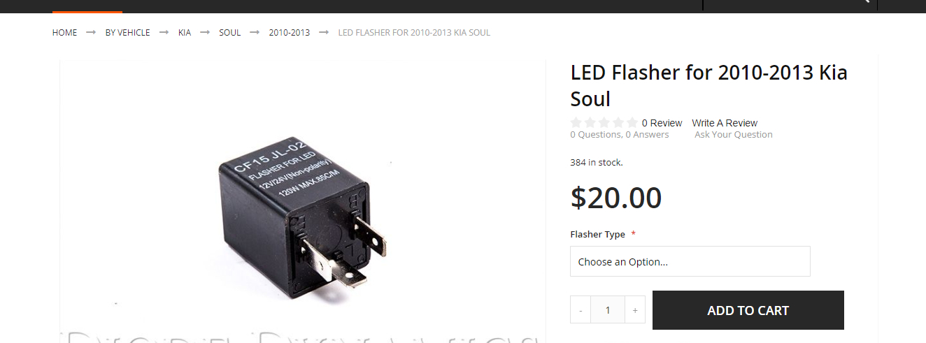

I'm trying to change all light bulbs in my car to LEDs in order to prevent draining the battery. i was told about hyper flash issues with turn signals. load resistors are going to create heat which makes LEDs pointless. but I'm assuming changing flasher relay might work.
does anyone know flasher relay location for my car?

I believe they make a turn signal flasher for HID.
If you look below, the first two pics get you to the flasher. Pic 3 is what I believe you need.
Let me know if this helps.
