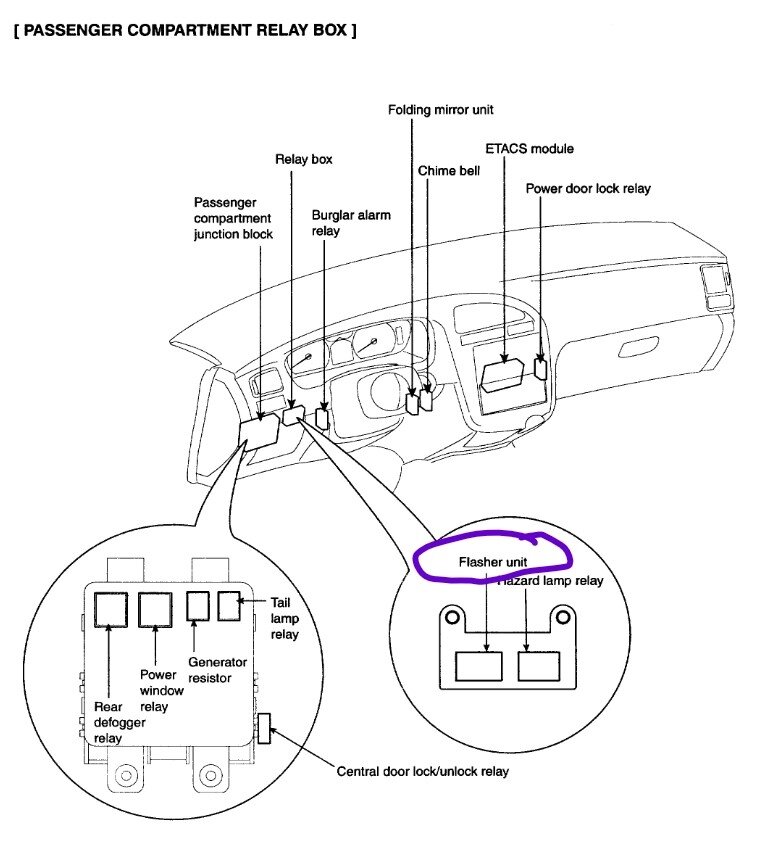

Can't find turn signals flasher relay location
Apr 26, 2026 at 6:11 AM
STEVE W.
Experienced Mechanic
15,399 POSTS
It is behind the dash to the left of the steering column.
Image (Click to enlarge)
