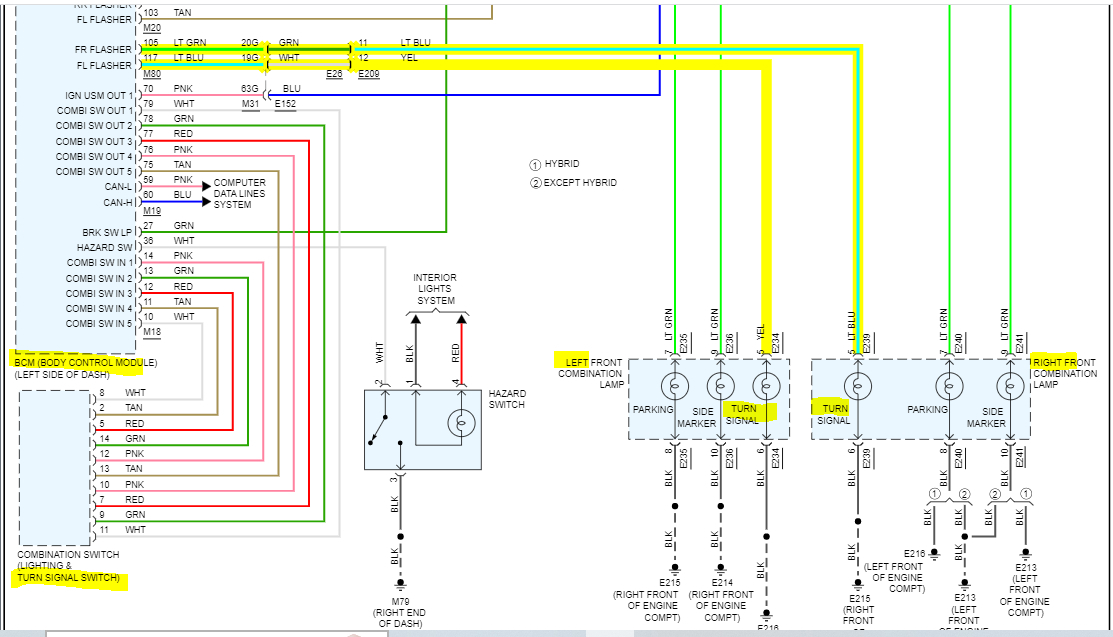

i cannot find the turn signal flasher relay.
Nov 21, 2022 at 5:38 AM
  • 110,244 POSTS
This vehicle doesn't have a traditional signal flasher. The signals are controlled by the body control module.
I attached a pic below showing the power distribution for the front lamps only. Note that when the signal switch is used, a signal is sent to the body control module. From there, the module actuates the signals.
Let me know what is happening and if the hazards are working properly.
