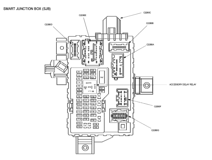

Where is the turn signal flasher located?
2007 LINCOLN NAVIGATOR
1,110,000 MILES • 5.4L • V8 • 2WD • AUTOMATIC
MICKEY_797
I need to find the location of the flasher so I can replace it.
Aug 23, 2023 at 8:38 AM
  • 110,194 POSTS

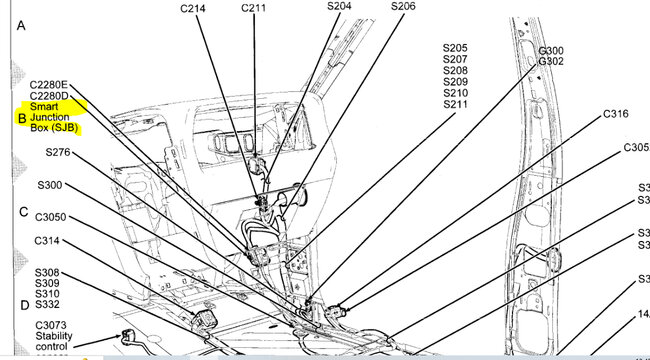

This vehicle doesn't have a traditional signal flasher. Instead, the flasher function for this vehicle is provided by the Smart Junction Box (SJB) and not a flasher.
If you look below, I attached a picture showing the SJB location. It is located on the passenger side under the dash. Pic 2 is a front view of the SJB.
Let me know what is happening and hopefully, I have some ideas of the possible cause.
