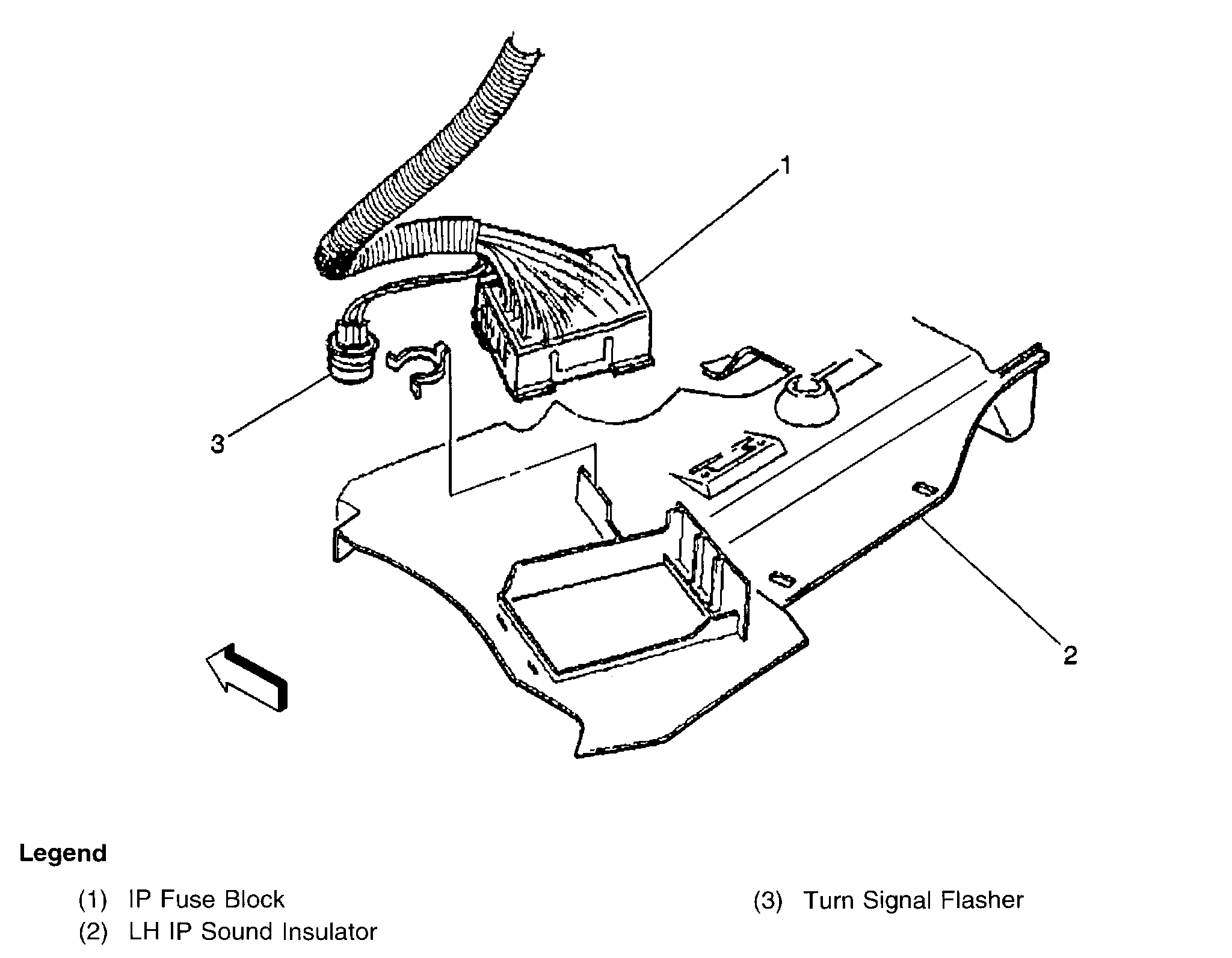

Turn signals do not work. Four way flashers work, all lights work, just no turn signals.
Aug 31, 2018 at 2:47 PM
  • 110,194 POSTS
The flasher is located under the left hand side of the instrument panel. See number 3 on the attached picture.
