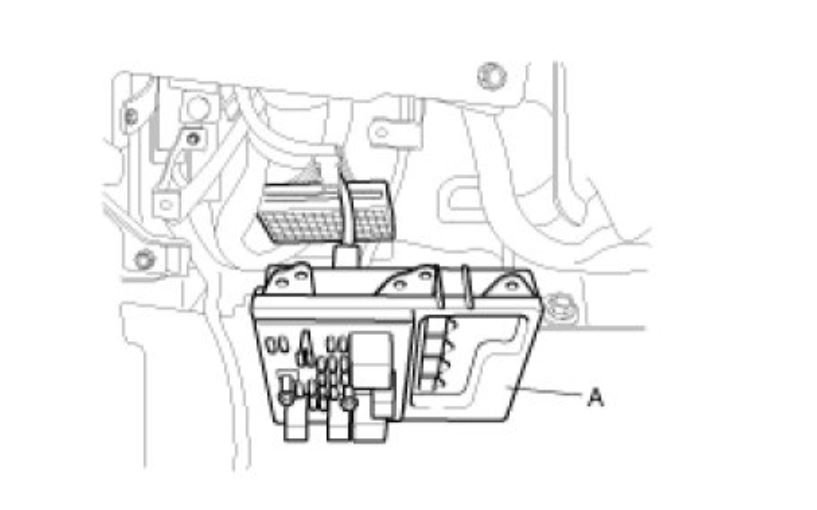

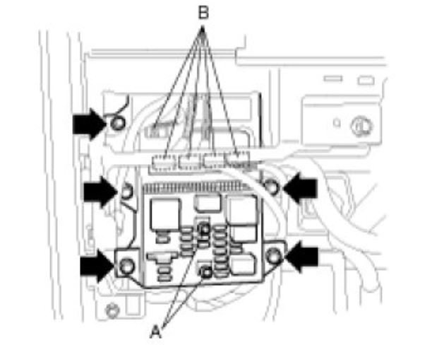

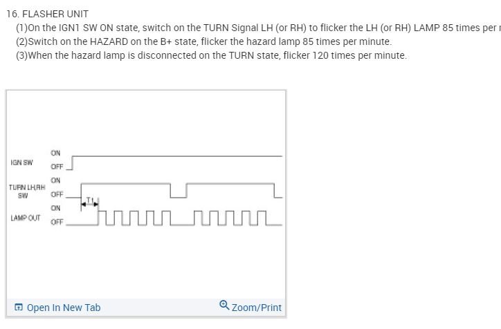

The body control module controls the flashing on the turn signal based on input from the multi-function switch.
Do the 4 ways work correctly?
Are all the bulbs lighting up?
