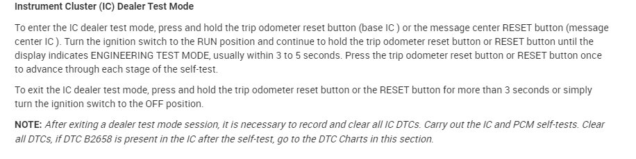

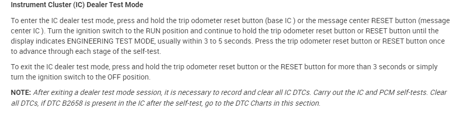

We really need to scan the can-bus to see if there are any codes stored. CAN stands for controller area network. Basically, the different modules are tied together via a few wires. This type of scan will retrieve codes regardless of the module storing them. Here is a link showing how it's done.
I noticed there are many codes related, so this could potentially point us to the issue.
I also found a test and attached it below. Take a look at it and let me know if you are comfortable performing it.
See pic below.

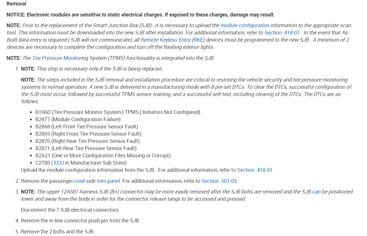

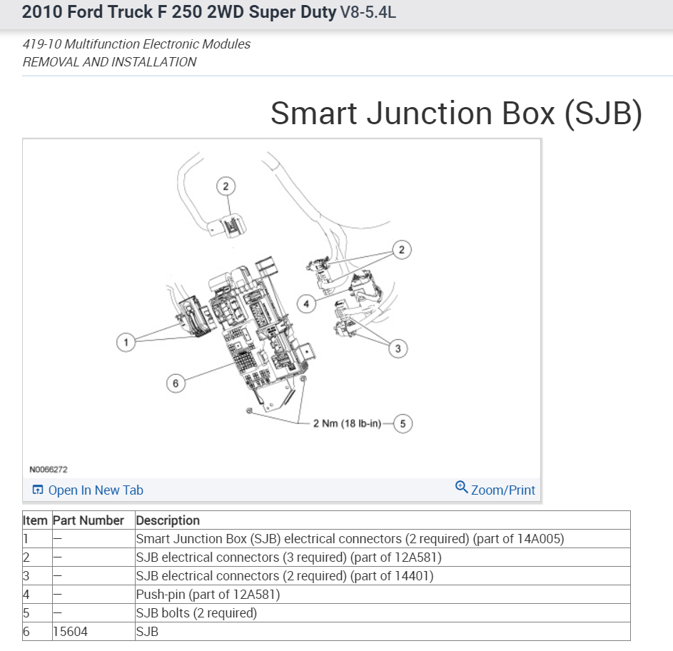

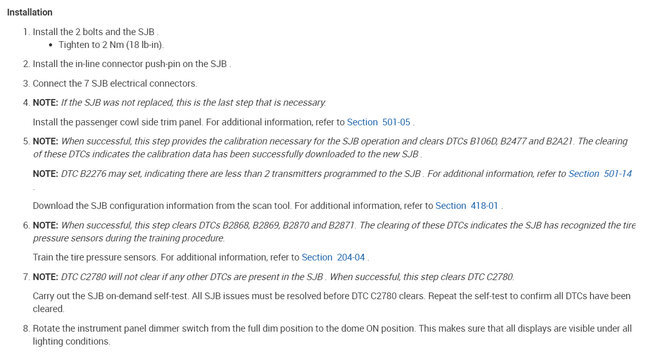

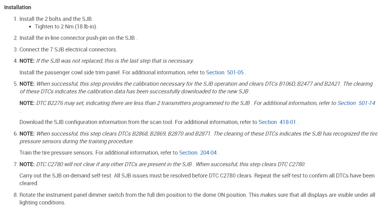

The chime is produced through the radio speakers, can I ask if the radio is working? Also have you checked all fuses with the system on, this guide can help.
If the radio works and the fuses are good it sounds like the SJB (smart junction box) is going out but to be sure let's do a CAN scan, you can get a CAN scanner (Controller Area Network) which will work on most cars from Amazon.
https://youtu.be/u-4syLc-ifQ
Here is how to change the SJB out, check out the images (below). Let us know what happens and please upload pictures or videos of the problem so we can see what's going on.
