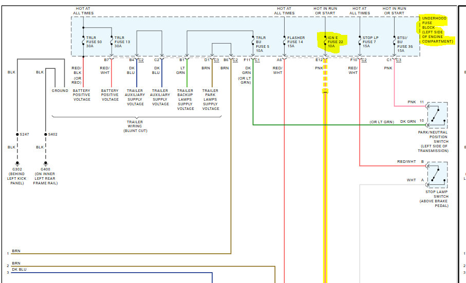

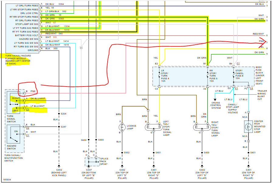

Hello. The turn signals in this vehicle do not work. I have replaced the relay which got the hazards working. I replaced the multifunction switch which did not fix it. Right now, hazards, brakes, headlights are working. Just not the turn signal. How do I find the issue?

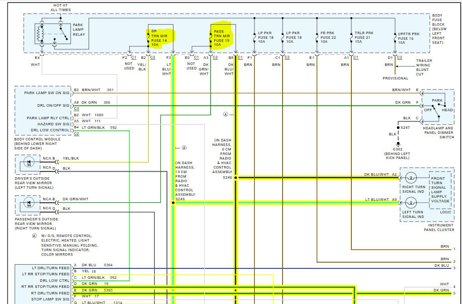

I'm looking through the wiring schematic and never saw one so confusing. I attached three pics below and need you to check all the fuses indicated. Specifically, check the ignition E fuse in the under-hood fuse box. That supplies power for the signals signal switch. It appears the hazard gets power from a different place.
When you check these fuses, make sure there is power to and from them.
Let me know what you find.

Hello. Thanks for the info. The turn signal fuses at position 3 and 4 are not receiving power. The fuses are good when they light up in other positions but not where they should. Also, the fuse in position 5 does not light up. Ignition fuse? Thanks for your help.

You lost me on the fuse numbers. Fuses 14 and 19 are under the driver's seat. Ign E (fuse 22) is in the under-hood fuse box. Which of these doesn't have power? And what do you mean they don't have power at the right time?
I need clarification to follow the power distribution schematics and see where power is coming from.
