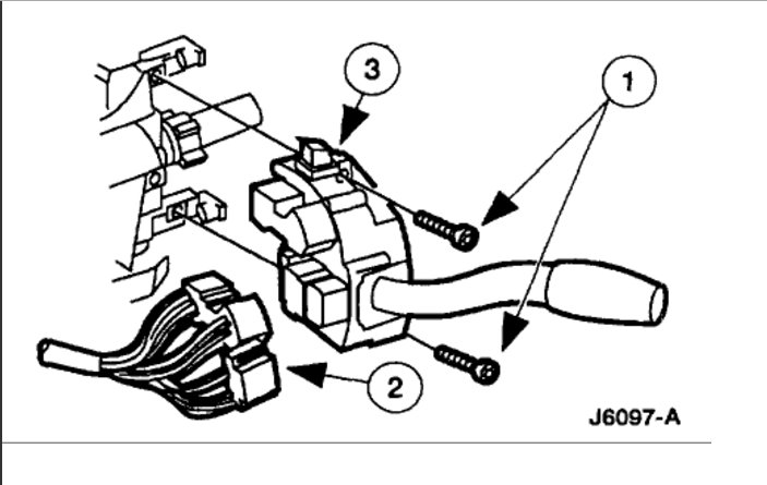

I need to replace this (I can do it). My truck's current combination switch has the orange hazard button versus the black which is all I can find.
A good install video said I need to be sure to get the right part. What is the Motorcraft part number that I should get? All I can find are black.
Thanks,
Mike
Aug 24, 2017 at 10:22 AM
  • 54,837 POSTS
Yes you can do it! lol love it. The only switches I can find have black too here is a Motorcraft part for $92.00 on Amazon.
https://www.amazon.com/gp/product/B000C5FUGM/ref=as_li_qf_sp_asin_il_tl?ie=UTF8&tag=2carprcom-20&camp=1789&creative=9325&linkCode=as2&creativeASIN=B000C5FUGM&linkId=d9c6cee92190510aaab873215e9c1fa6

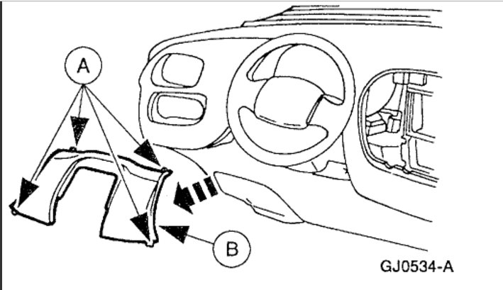

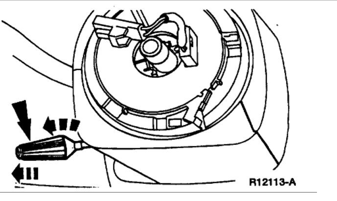

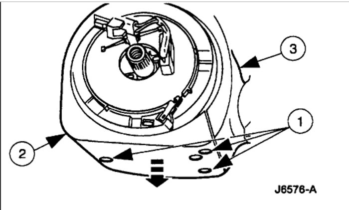

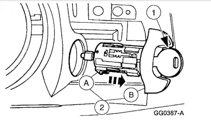

Here are some diagrams (below) that will help you. I do not think you need to do remove the ignition switch like the manual says you can get around it.
