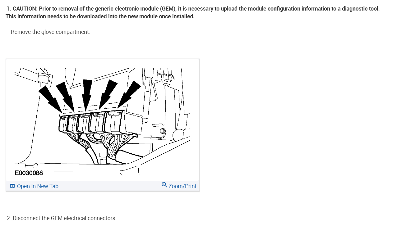

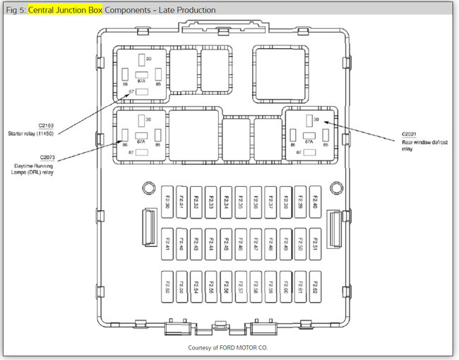

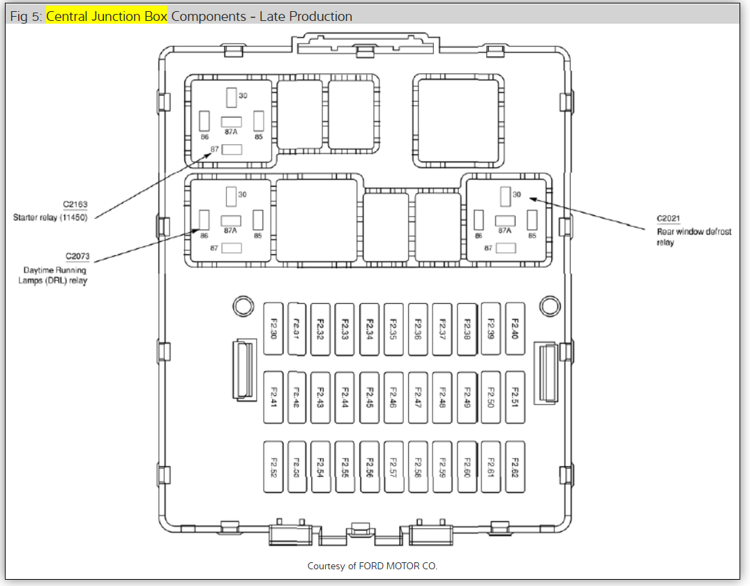

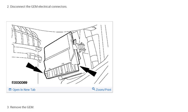

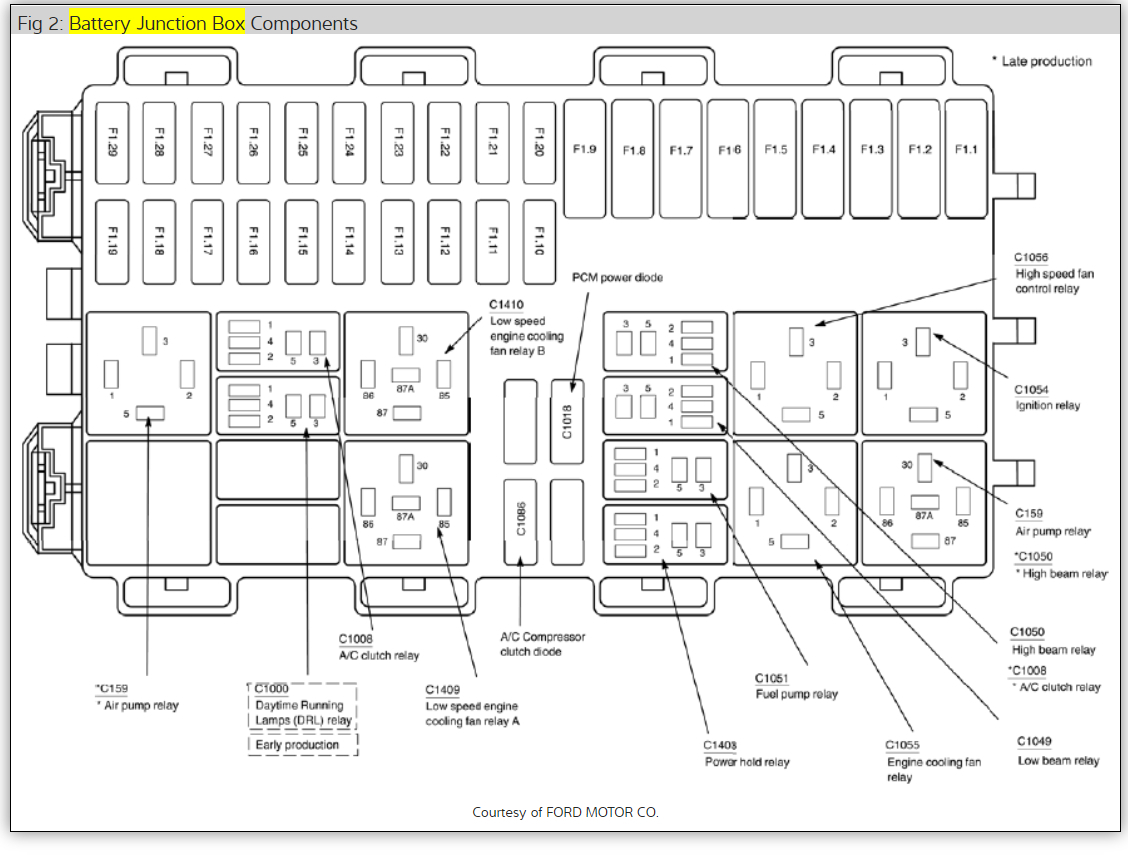

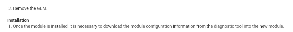

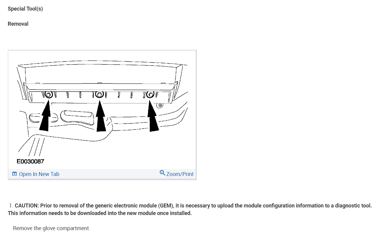

Yep, this is common when the GEM module goes out here is the location so you can replace it. First check all fuses, this guide will help:
You can get a preprogrammed unit by searching Google or Ebay. Check out the images (below). Please let us know what happens.
