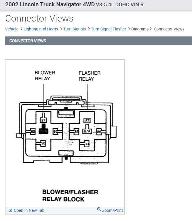

It does sound like a faulty flasher relay. The turn signal relay or the flasher are the same part.
This is likely to have too much internal resistance and gets hot and stops working.

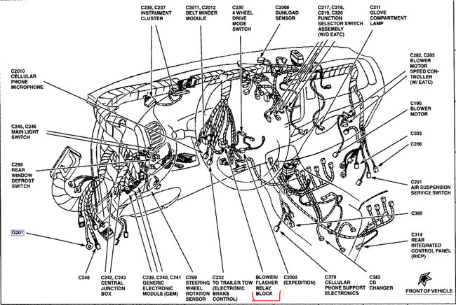

This is located under the dash, just right of the steering wheel.
I have attached a diagram showing its location.

I went to look for the Flasher relay and found it behind the dashboard on the driver's side. I think in touching it, I must have jiggled it a bit because it started working without stopping. I'll watch it for the next few days and see if it continues working correctly. Even if it fails, I know where and what to change now. Thank you very much.
