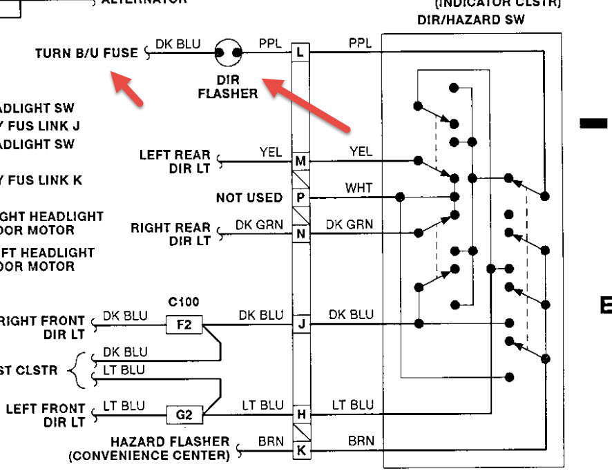

For some reason, my turn signals will not work. I have checked the hazard lights and they work. I have replaced the turn signal switch inside the steering column, replaced the turn signal/hazard flasher (looks like it is only one unit combined), and replaced the fuse inside the fuse box. I inspected all turn signal/hazard light bulbs and all are good. I do have a new 30 amp circuit breaker installed also in the fuse box. and yet the turn signals still are not working. Any ideas?

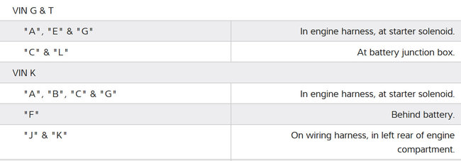

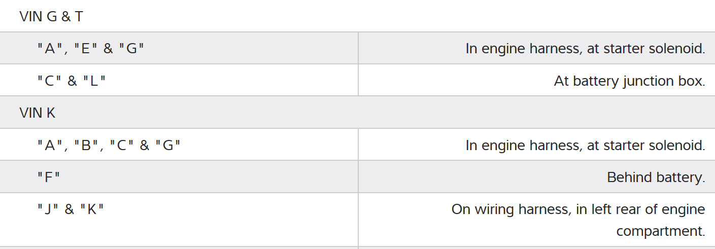

there is a turn signal relay on right side of steering column support for just turn signals. fuse 6 is for turn signals. See pictures for turn signal relay etc.
