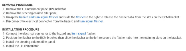

Turn signals just stopped showing up on dash and lights. Lever seems to work fine, just doesn’t display anything. Tried switching turn signal fuses, no luck. I’m pretty sure it needs a new flasher or something, but I wanted to see what you guys think. Before this, intermittently the signals would stop working but would work again once I activated hazards. Does not work anymore and isn’t responsive. Much appreciated.
Apr 10, 2023 at 5:50 PM
  • 54,840 POSTS

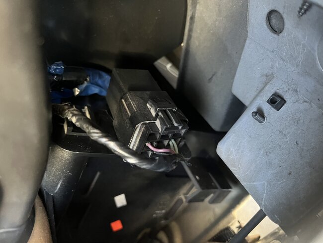

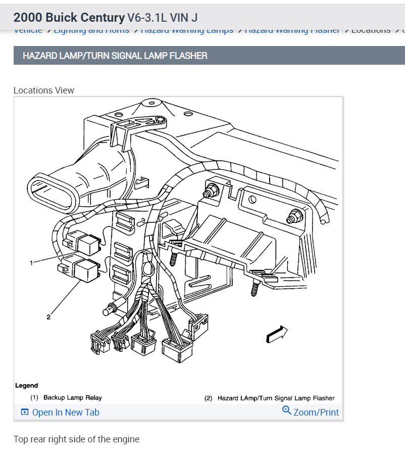

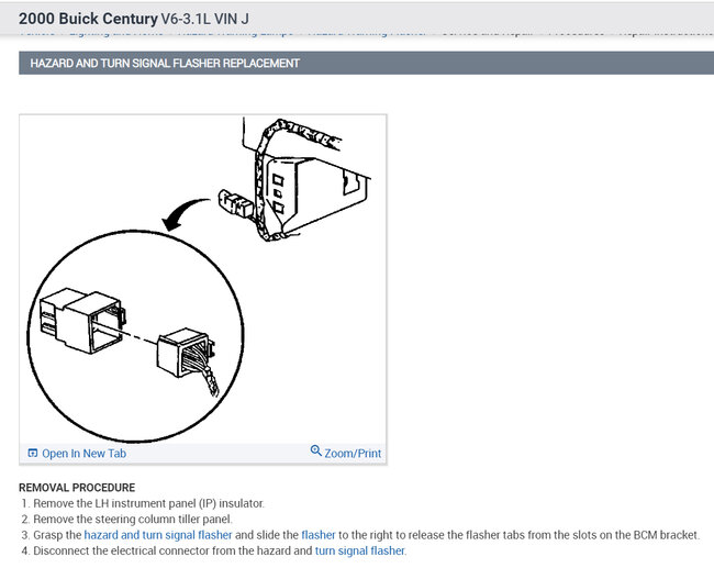

It is common for the combination flasher to go out in these cars. Here is the location near the steering column so you can swap it out which would fix the problem. Check out the images (below). Please let us know if you need anything else to get the problem fixed.

Hey Ken L. I just tried replacing the combination flasher with a Novita EP28 led flasher. It did not work. Is this the wrong kind of flasher or is it something else?

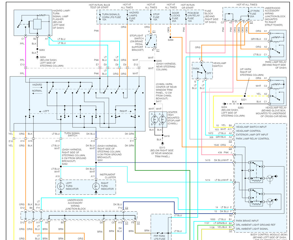

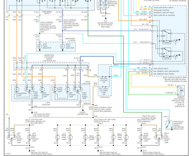

It sounds like you have the wrong or defective flasher. Here are the blinker wiring diagrams so you can see how the system works. I would check the grounds.
This guide can show you how:
https://www.2carpros.com/articles/turn-signals-not-working-blinker
