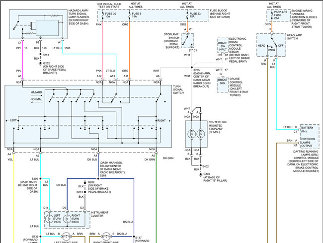

Brake lights stop working and turn signal lever won't go up or down.
Feb 17, 2020 at 1:18 PM
JOETECHPRO
  • 705 POSTS
Hey JEUBANK1,

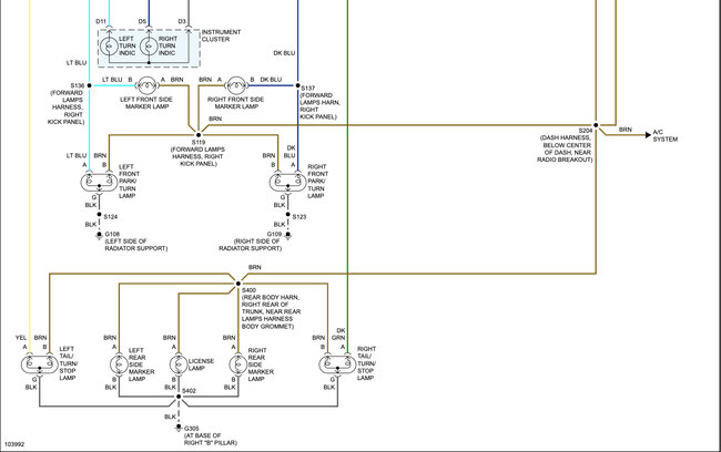

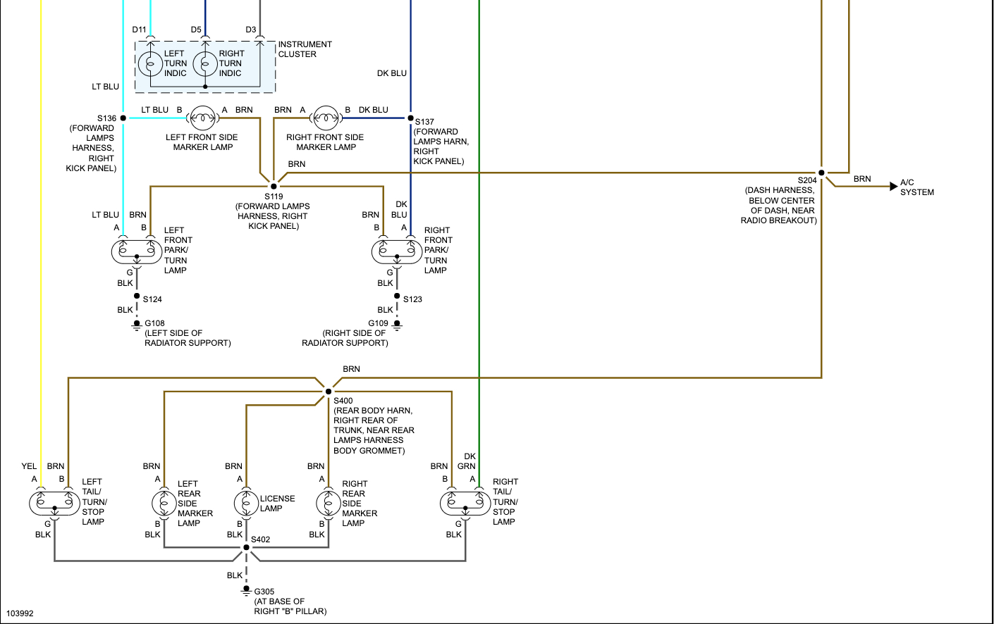

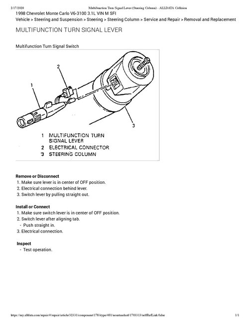

If the turn signal lever will not move then you have a faulty signal lever and it will need replacing.
The signal to the brake lights goes through this switch so it may be causing both of your issues.
Please see the wiring diagram attached.
I have also included the instruction for replacing the turn signal switch.
