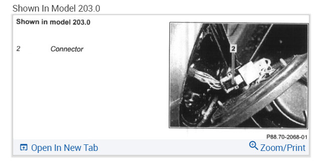

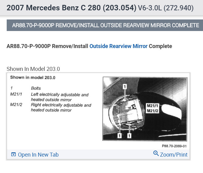

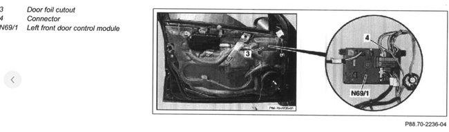

My turning signal light piece on the mirror got hit and cracked. The lights do not work, but I bought a new piece to replace that light piece. About how much would this cost me to get put in if I take it to a shop?
Nov 15, 2018 at 9:25 AM
  • 55,224 POSTS
Here are the instructions and diagrams below to help you change the mirror out and the labor time to do the job.
One Side 0.6 hours.
Nov 16, 2018 at 11:43 AM
