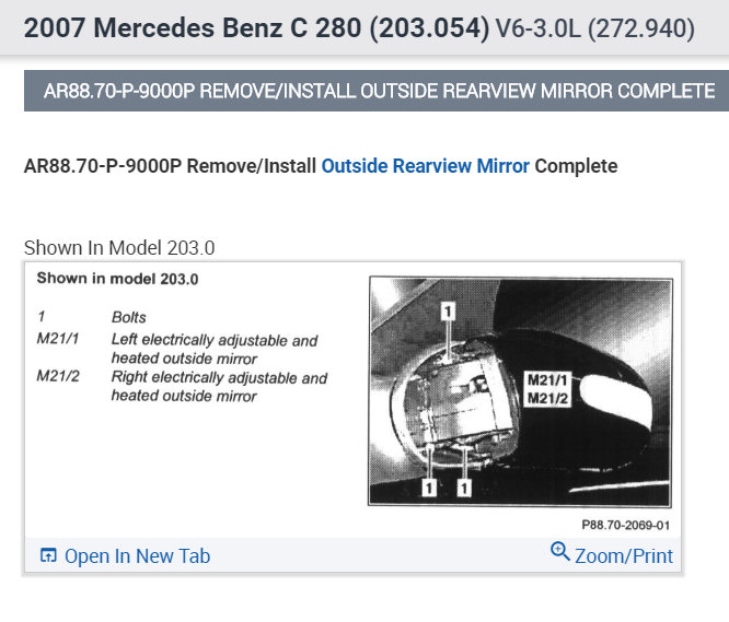

My turning signal light piece on the mirror got hit and cracked. The lights do not work, but I bought a new piece to replace that light piece. About how much would this cost me to get put in if I take it to a shop?
Nov 15, 2018 at 9:25 AM
  • 55,746 POSTS

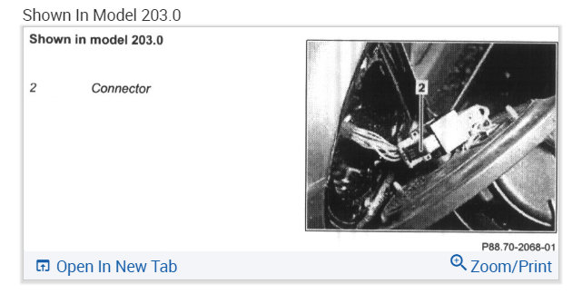

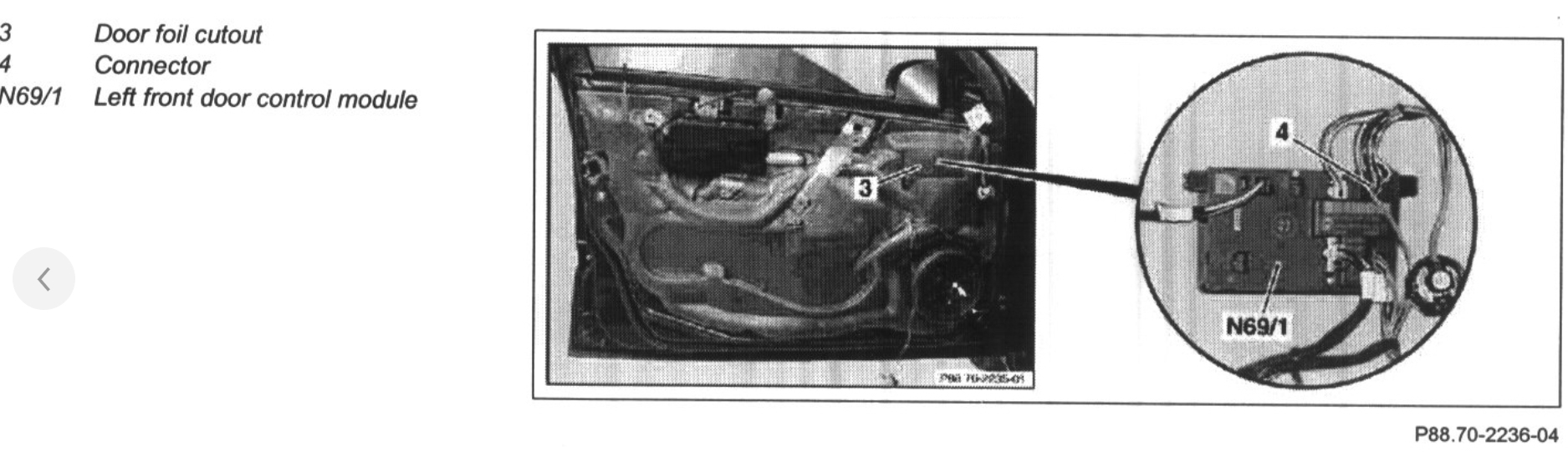

Here are the instructions and diagrams below to help you change the mirror out and the labor time to do the job.
One Side 0.6 hours.
