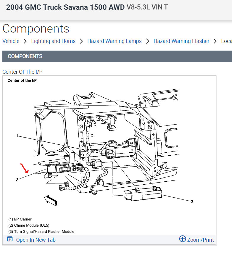

Does the rear blinker for the right-side work? If not, this will be the problem, if it does work, I would check the rear bulb as well because the resistance might be off causing the fast blinking, here is a guide to help as well:
https://www.2carpros.com/articles/turn-signals-blink-rapidly

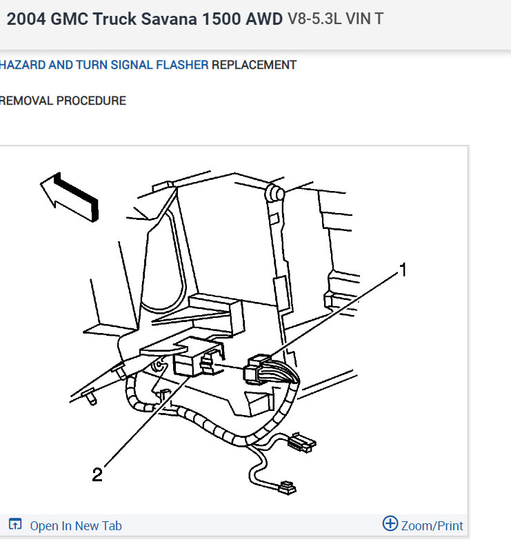

If it still blinks fast with both new bulb, I would swap out the turn signal flasher. Check out the images (below). Please let us know what happens.
