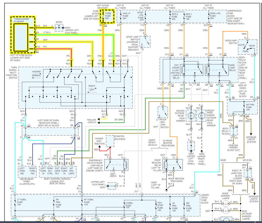

Our turn signals won’t work, they have power. fuses working but we can’t get them to work and don’t know the issue we have been trying for the last year to figure it out but I’m not sure.
Dec 16, 2021 at 3:46 PM
Good evening,
I attached the supply for the turn signals for you to view. Check the fuse I circled for power on both sides.
If it is good, you need to go to the switch and verify power from that wire to the switch.
