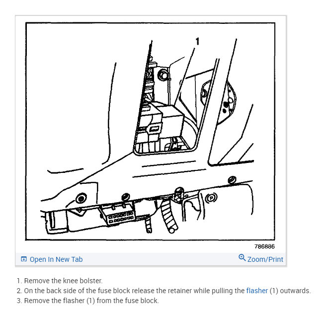

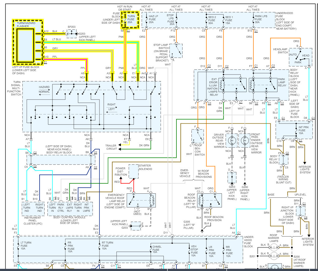

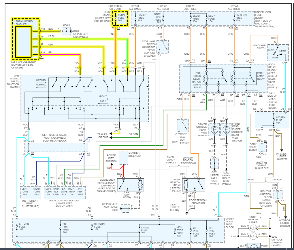

I attached the supply for the turn signals for you to view. Check the fuse I circled for power on both sides.
If it is good, you need to go to the switch and verify power from that wire to the switch.
