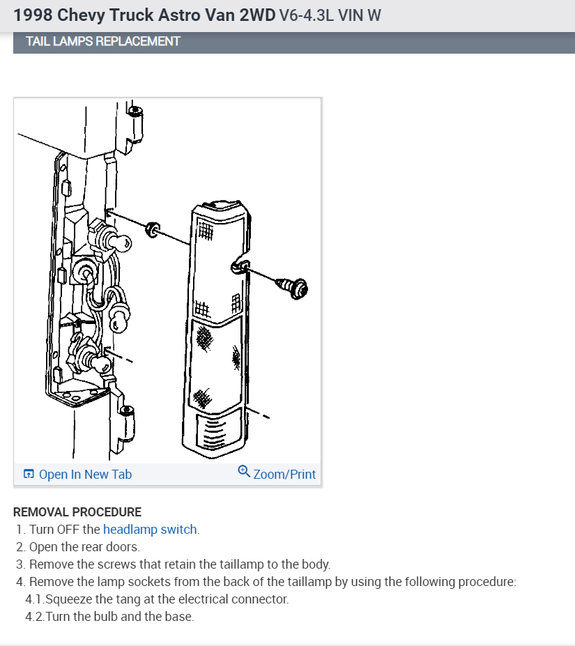

When turning on the headlight switch, the right passenger side blinker stays solid and does not work?
170,000 MILES • 4.3L • 6 CYL • 2WD • AUTOMATIC
EDDY EGC
left driver and right passenger side blinker works, hazard light works. left and right rear blinker work, backup lights work.
Jul 21, 2022 at 3:05 PM
  • 55,732 POSTS

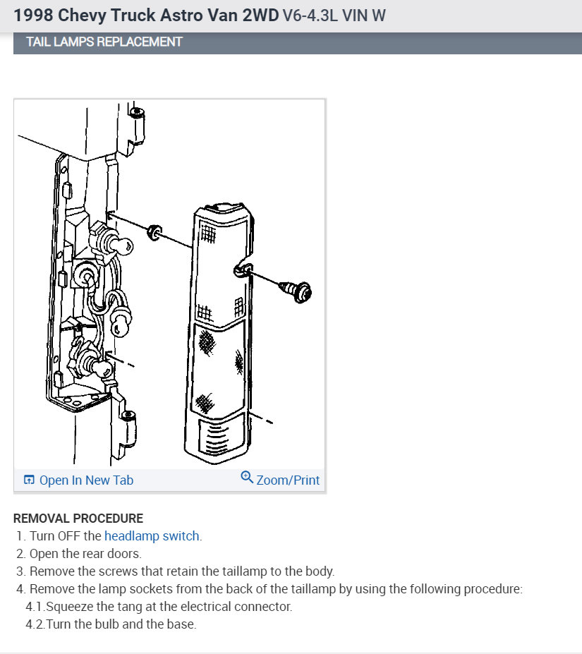

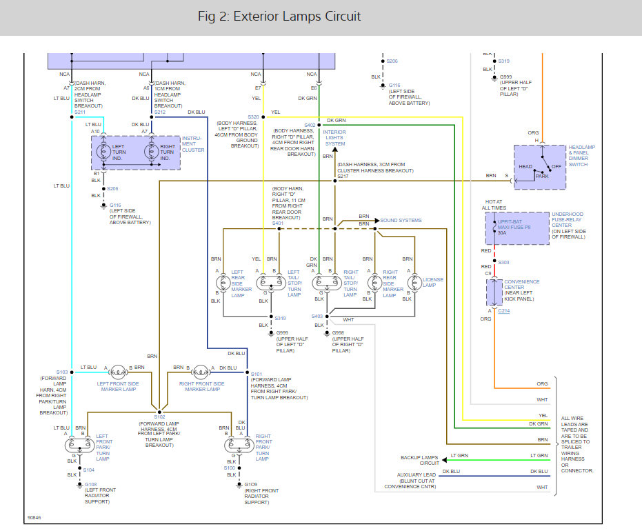

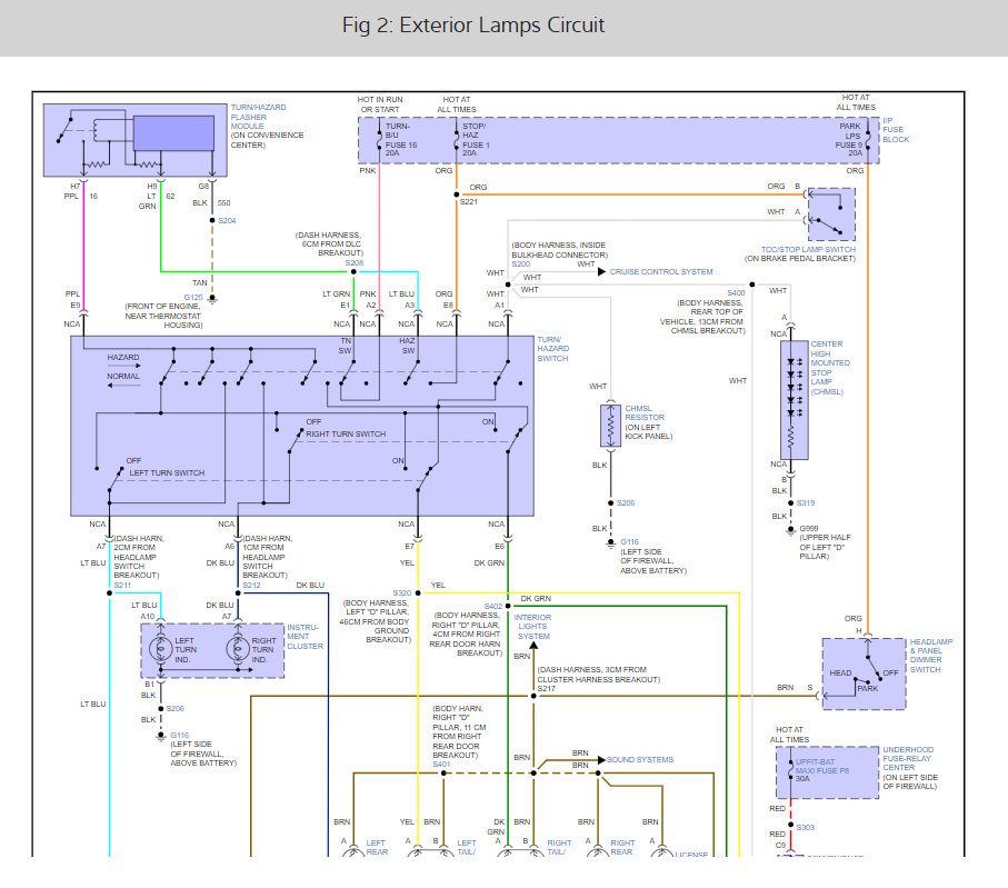

Yep, this happens when the right passenger side blinker has a bad ground or the bulb socket is melted allowing a back feed condition when the headlight is on, lets remove the right rear blinker assembly to check it out here are the instructions in the diagrams below. Also, I have included the blinker wiring diagrams so you can see how the system works.
This guide can help as well:
https://www.2carpros.com/articles/turn-signals-not-working-blinker
Check out the diagrams. (Below) Let us know what happens and please upload pictures or videos of the problem.
