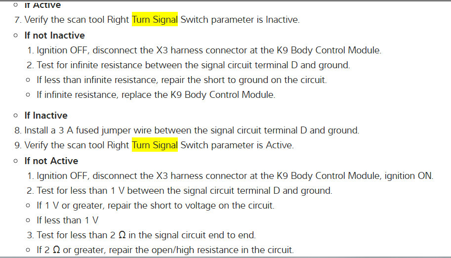

When I turn on the left turn signal it flashes four times then says fault detected and hyper flashes. It is a Denali so it has the LED lights. Checked the connection and it is good.

No there is not a check engine light on. When I turn the left turn signal on it flashes normal four times then starts flashing fast. The display on the dash says left rear turn signal fault detected. When the turn is complete and the signal goes off and the signal resets the display goes away. It is only the left signal that does it.

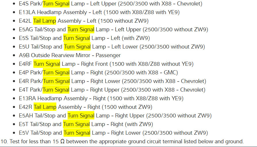

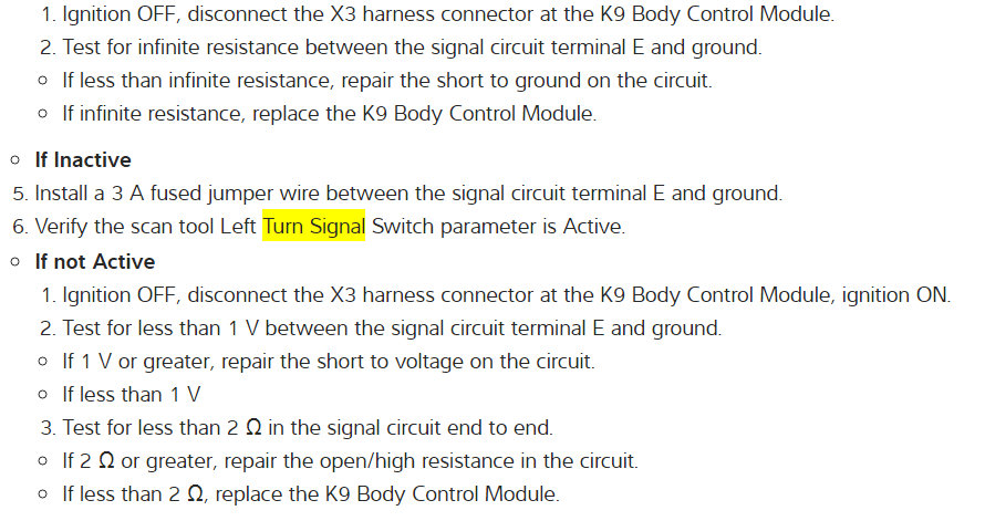

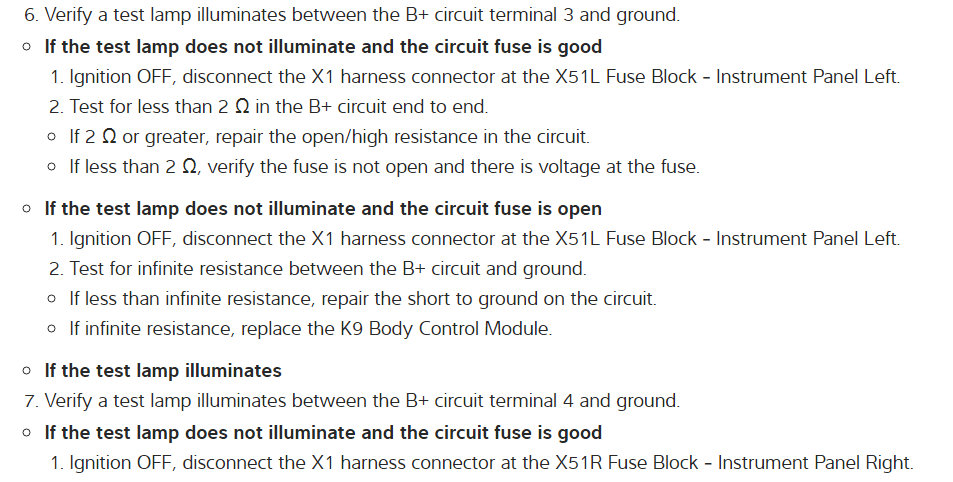

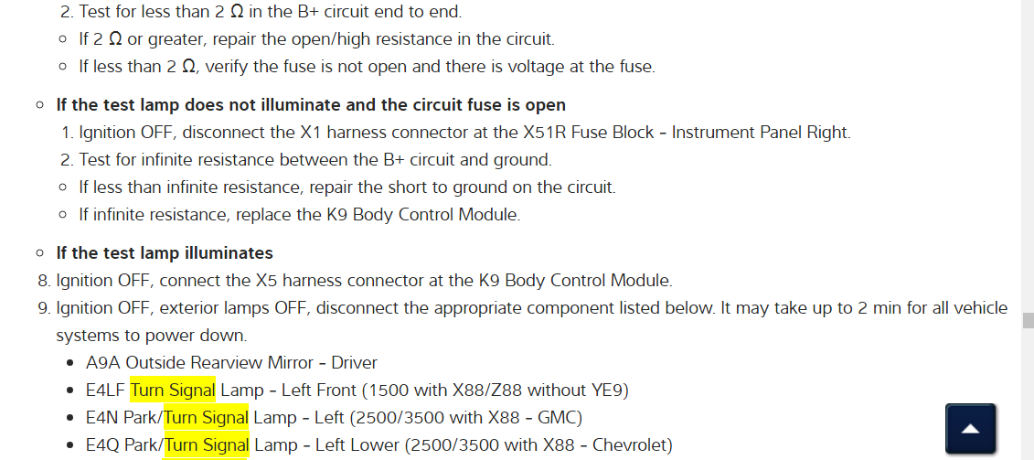

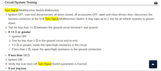

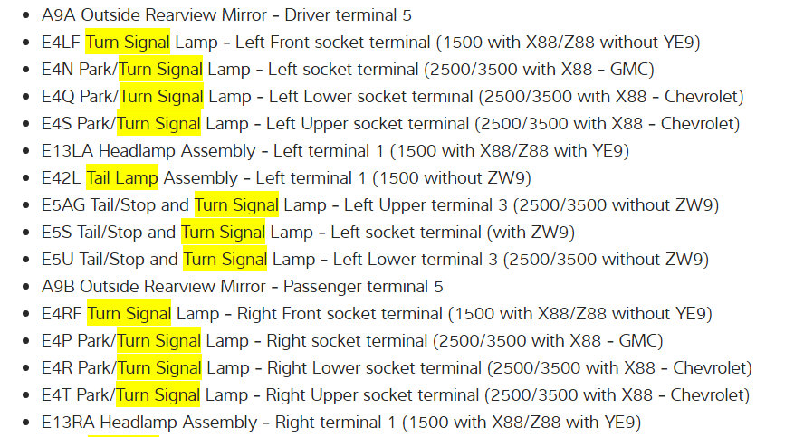

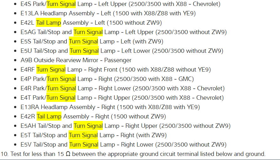

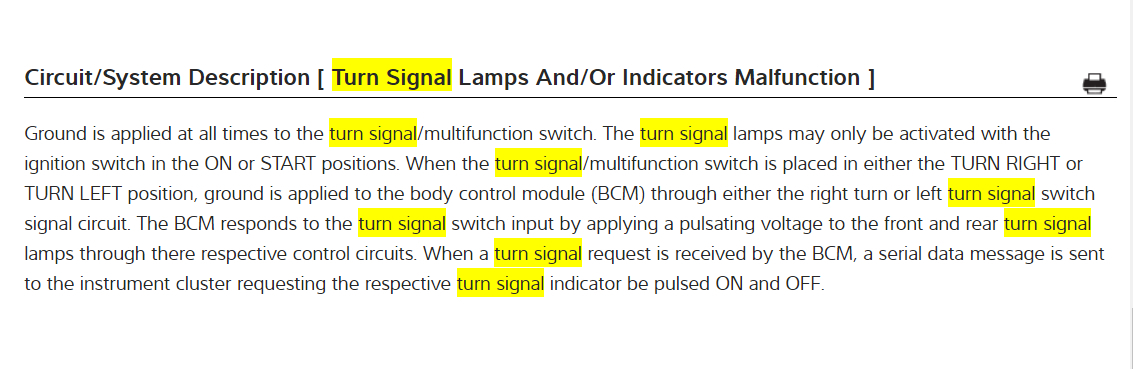

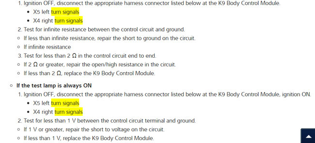

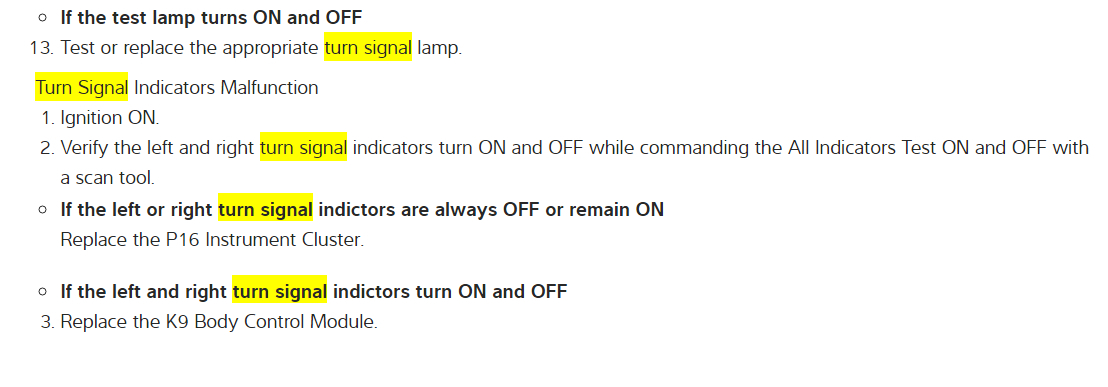

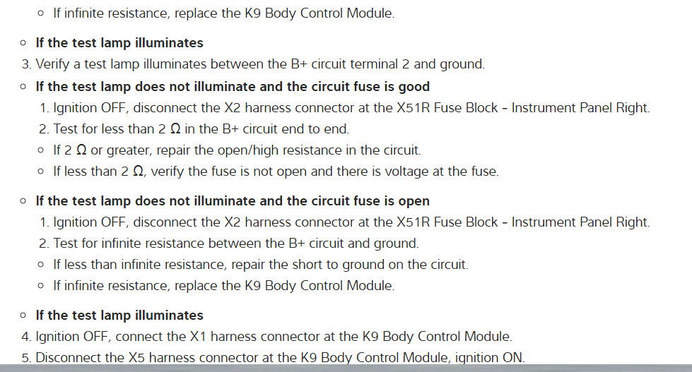

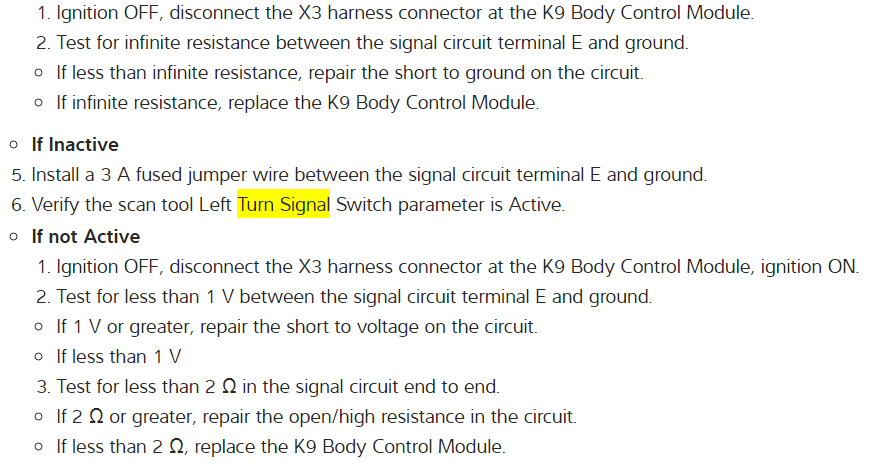

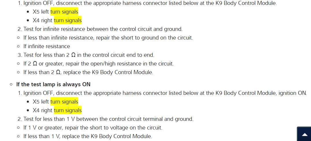

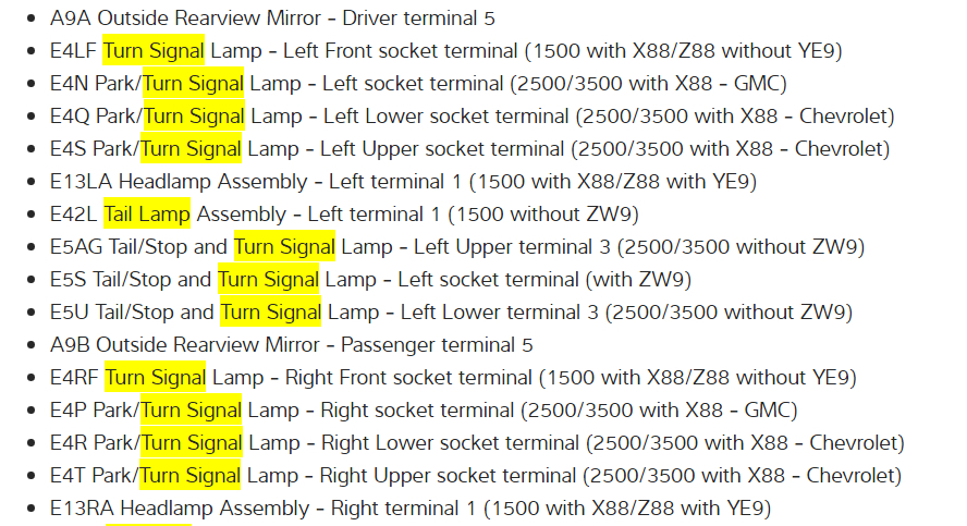

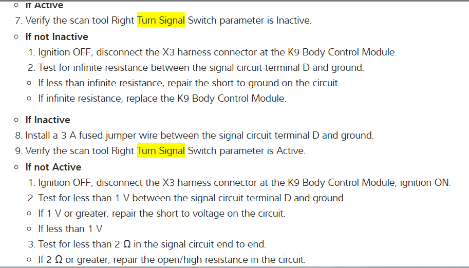

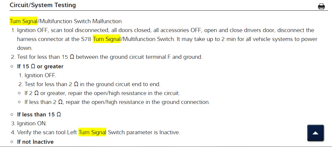

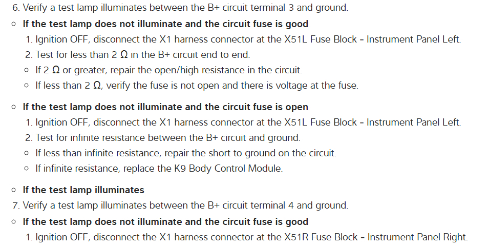

SCGRANTURISMO
  • 4,897 POSTS
Hello again,

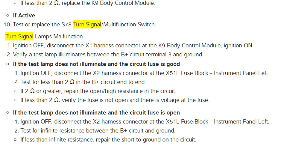

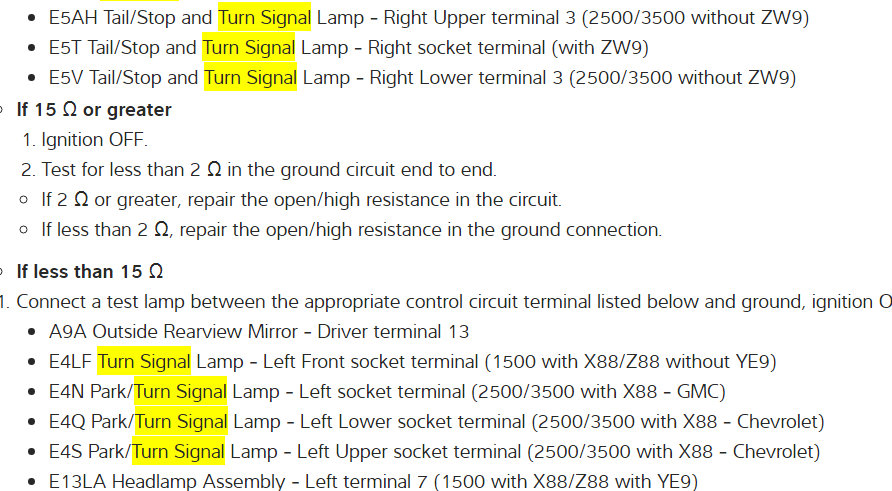

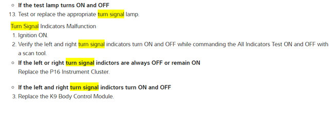

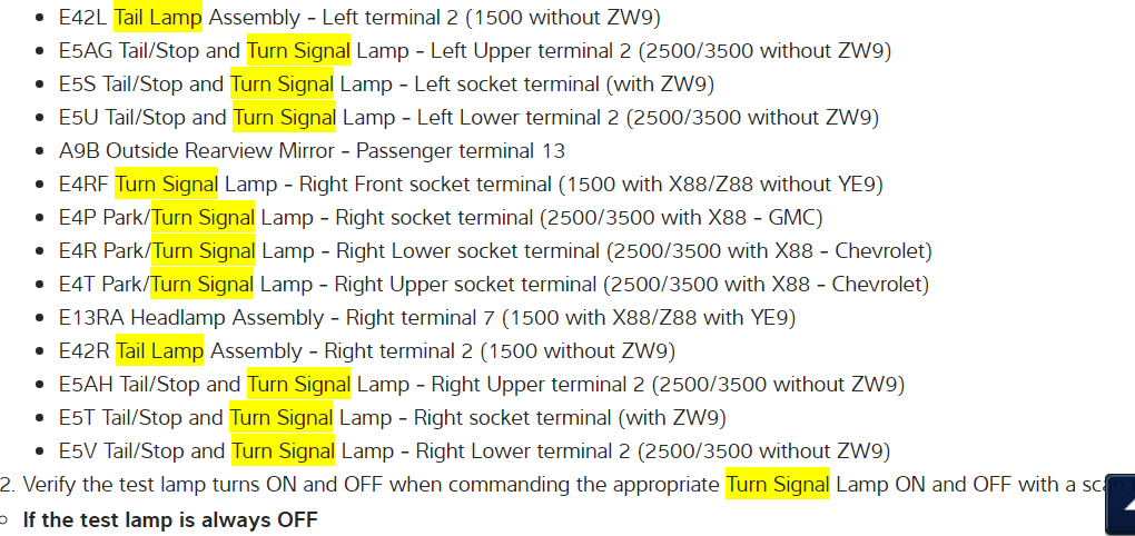

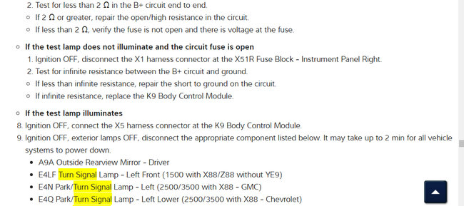

I have included for you the factory diagnostic troubleshooting guide for your vehicle's turn signals in the diagrams down below. It is quite involved, so please be patient and go through it step by step. It will require you to use a multi-meter so I have included a link for you to go to below if you are unfamiliar with how to use one.
Please go through these guides and get back to us with what you are able to find out, please.
Thanks,
Alex
