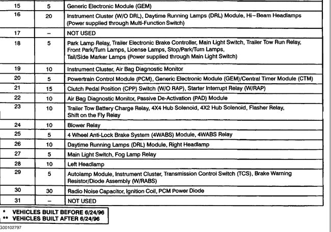

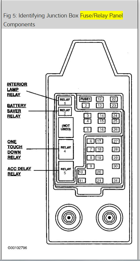

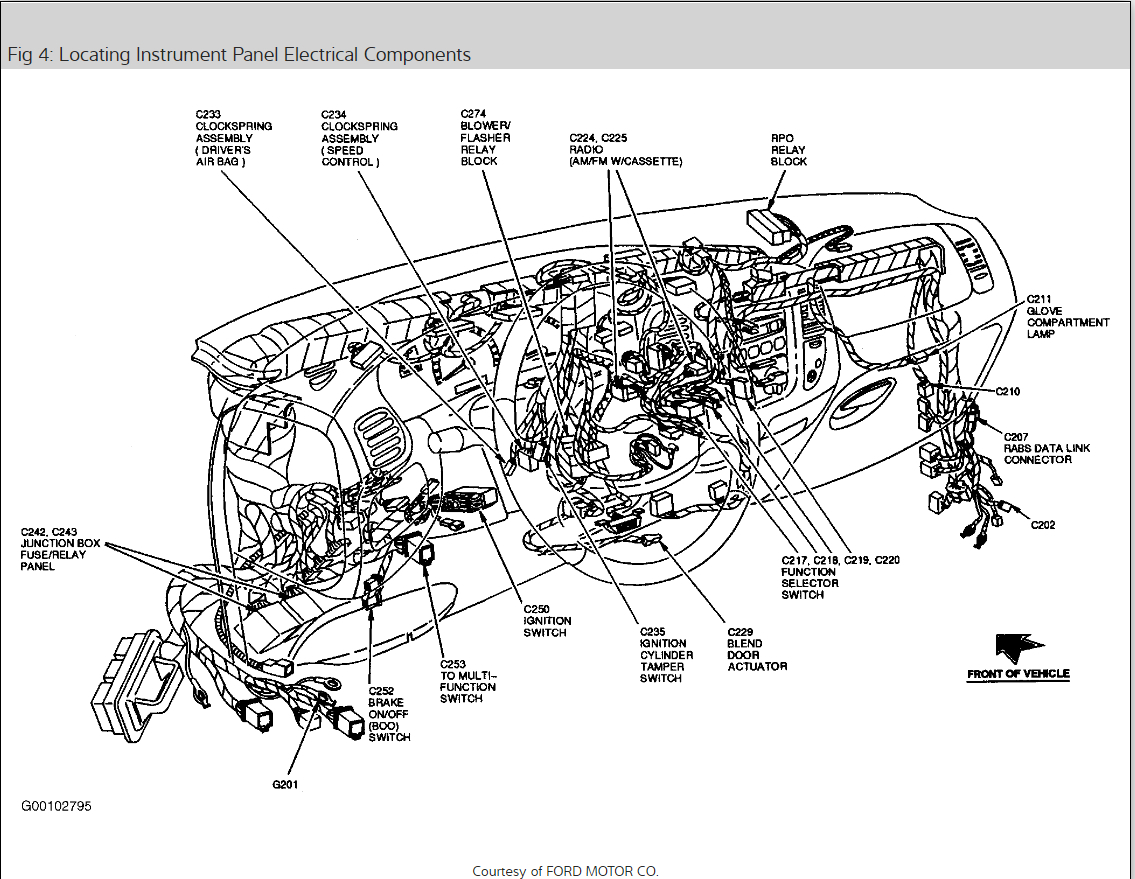

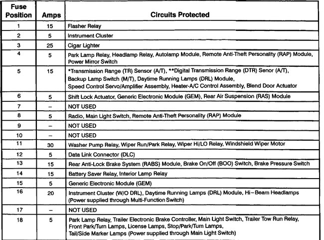

Need to know what number fuse is for turn signals, no manufacturing manual available. Also, where would the turn signals fuses be under dashboard or under hood?

It is in the fuse relay panel under the left side of the dash, fuse#18(5A). I have included a diagram for you in the diagrams below.

Thank you BMDOUBLE. Yes, I did see rust on panel door.
Thankfully once I found the fuse and diagram of panel, a new fuse finally.
