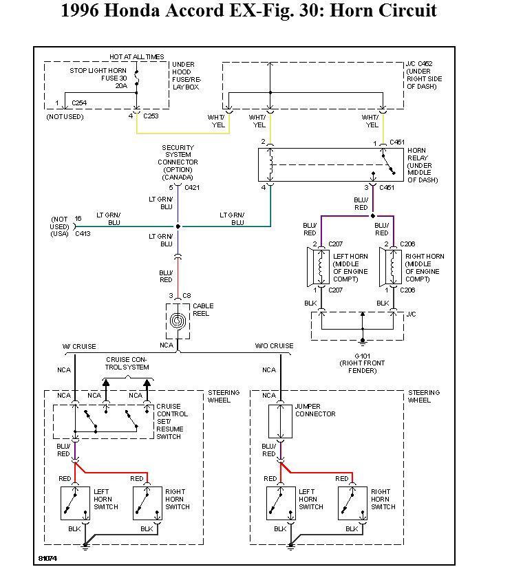

I have a 96 accord when I turn on the headlight the horn will sound until I turn it off.
During the day everything normal. Horn will work when I press the horn pad.
I try to pull out the horn fuse and turn on the headlight the horn still sound.
Please advise Thank You

Attached is the horn schematics. Check for a short between lighting sires and horn. If the horn/stop ligh fuse is removed and horn still sounds, the shorting should be be after the relay and most likely near the horn.

this problem is not happen all the time. It is really hard to find were the short location.
Do you have any suggestion ?

It is never easy to find the location. Look out for repaired wirings and impact damages.
Is vehicle equipped with or without Daytime Running Lights?

Finally found the problem is on the RF tire area. The wires got damage touching together.
