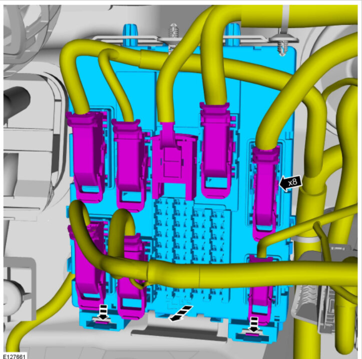

I have seen the BCM go out in these cars which can cause the problem, but also, I would disconnect the battery and remove the electrical connector from the BCM to check for correction which can cause the issue as well. The BCM is on the lower right side of the dash and can get wet to cause the issue. Please upload a short video in your response of the problem, so I can see what's going on. Check out the images (below).

Yes, when you disconnect the battery and remove the BCM electrical connectors, then use a flashlight if there is a problem you will see corrosion on the terminals inside the connector and on the BCM side as well. Please upload an image or short videos in your response of the problem. That way I can tell for sure.

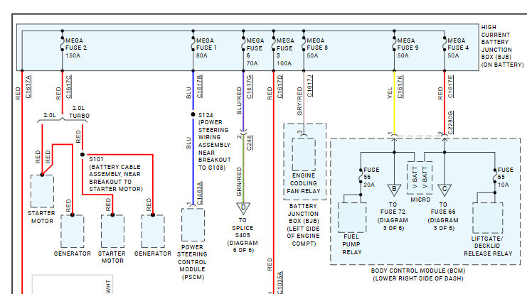

No worries, glad to see you back. So with the key on I would check the fuses and fusible links for power, here are the fuses to check and a guide to help you check the fuses for power on both side.

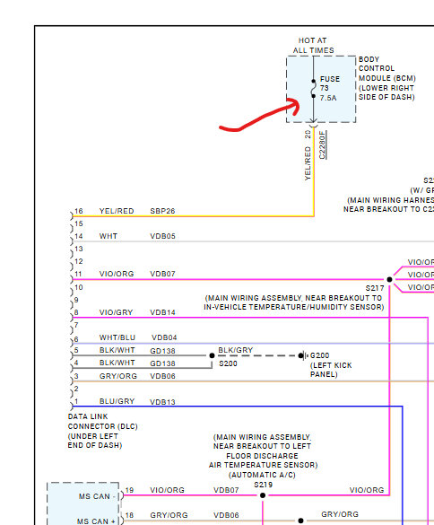

The fuse for the data port is fuse #73 on the BCM so check that as well. Also, check the main battery for 12 volts. If the voltage is low the car will act strange.

See if you have power at fuse #73? Also, check the blk/wht wires and the data port connector to see if they have ground. This guide can help.
Please go over this guide and get back to us.
