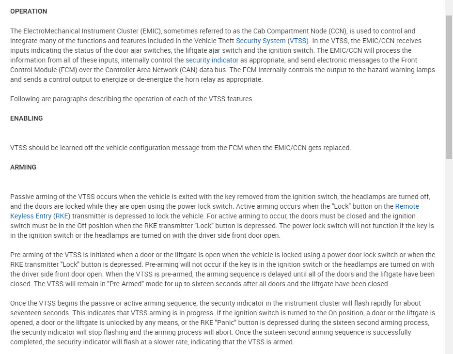

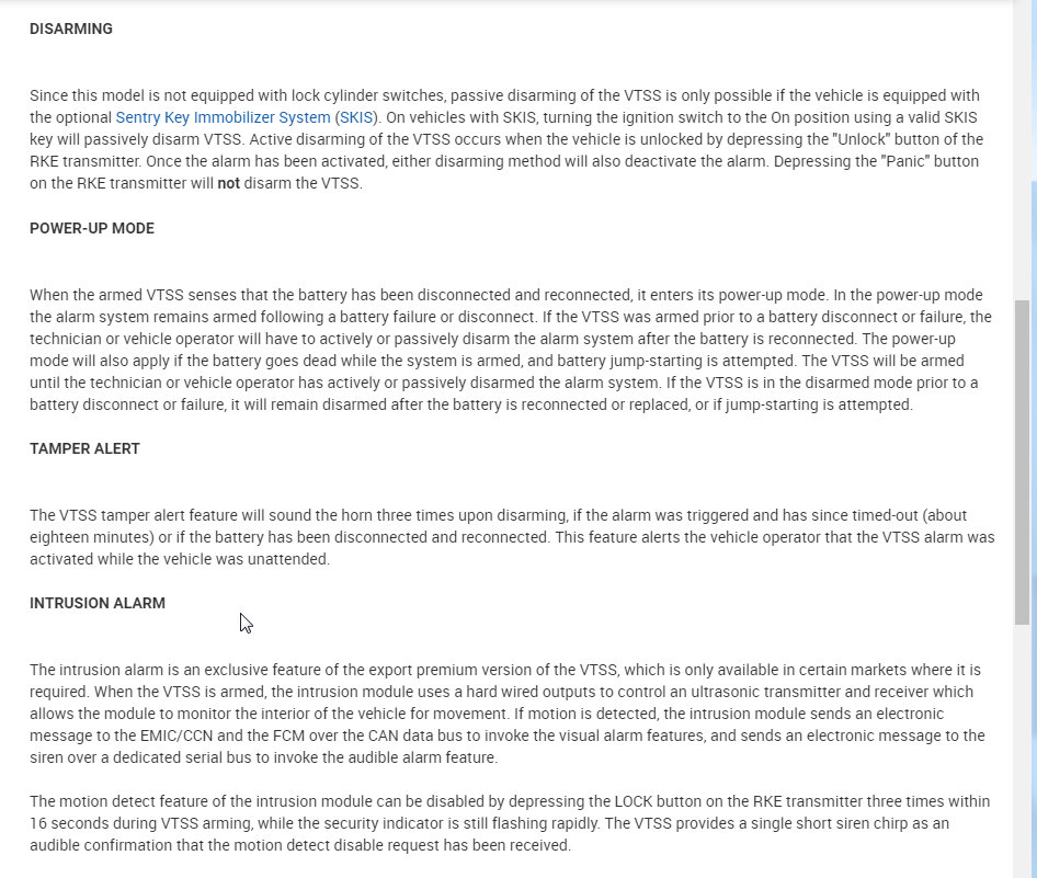

Does the theft light ever turn off or is it flashing?

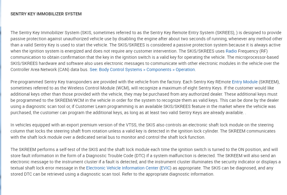

This could be a security issue but either way, we need to check for codes and see what that is telling us.
Here is the info about the theft system but if this is armed it will cause this issue. It may not be just as simple as unlocking the doors if there is an issue with the system.
