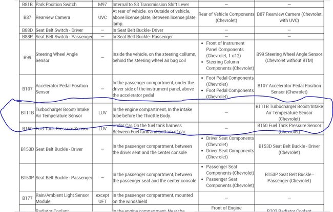

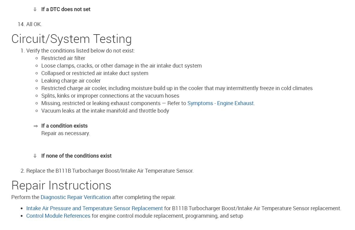

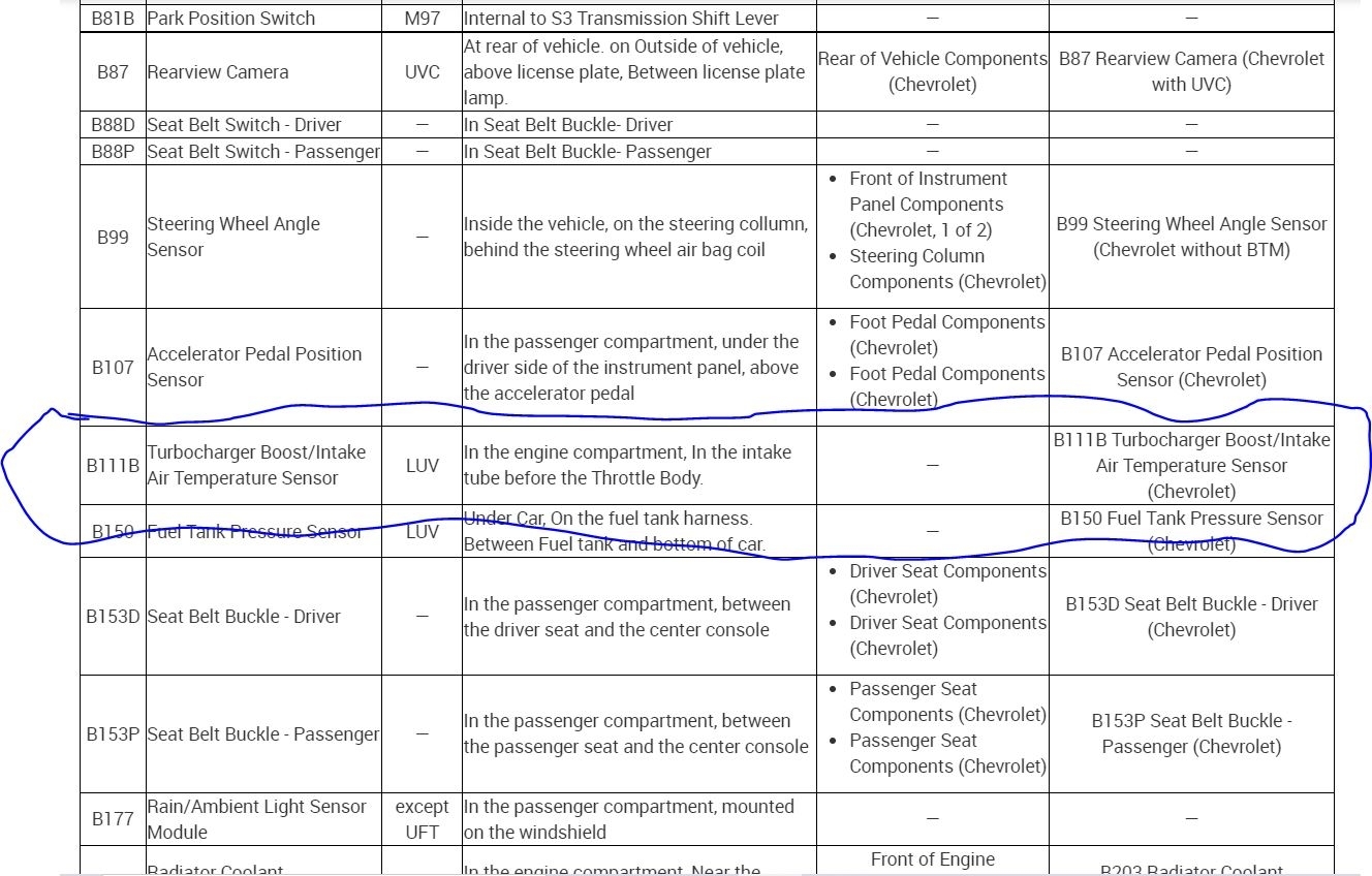

I cleared the code, and it just keeps coming back. I want to check the sensor, but I can’t find where the sensor is.
Jan 5, 2022 at 1:05 AM
Experienced Mechanic
52,796 POSTS
Good evening,

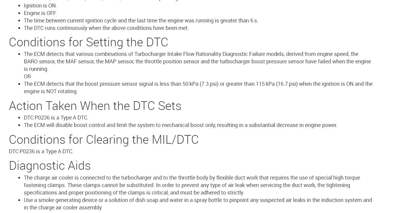

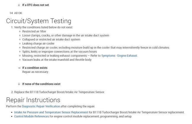

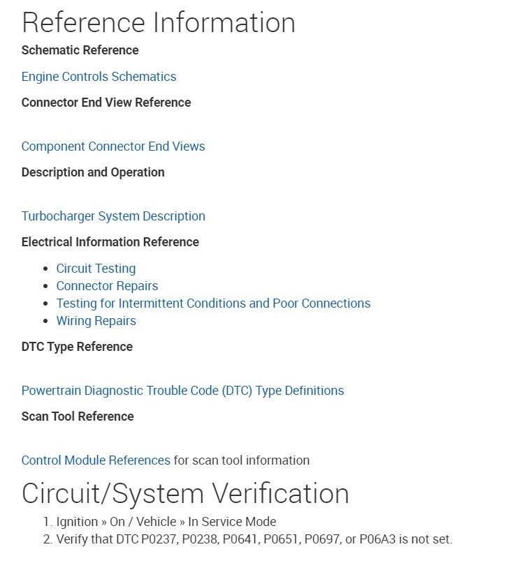

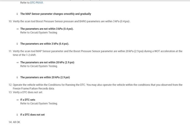

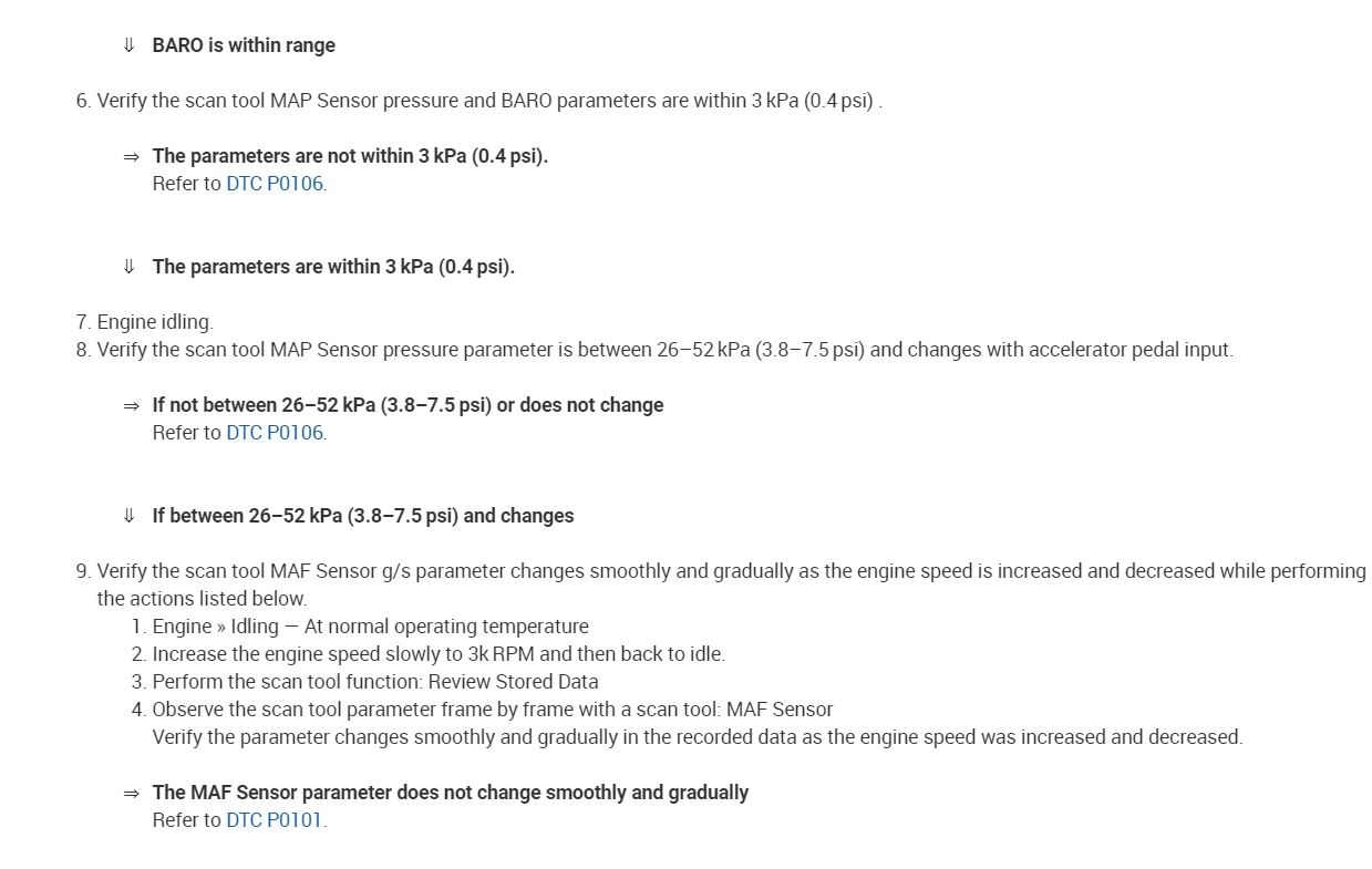

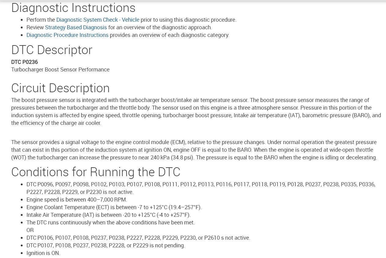

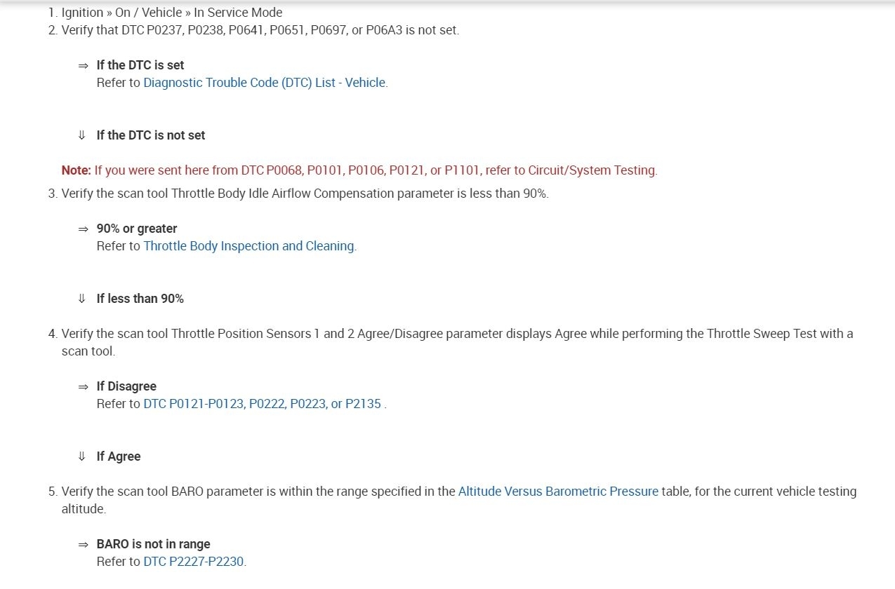

I attached the flow chart for you to view. This could be the sensor but more of a chance of the turbo itself being the failure.
You will need a scan tool capable of monitoring the turbo system.
Let me know if you have any follow-up questions.
