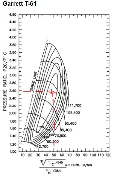

This will be a pretty large project then but starting off, based on the displacement and some assumptions made about the stock engine, I did some rough calculations. You would need to move about 750 CFM of air @ 6000 RPM to make 500 Hp. Shopping around, and I like Garrett by the way. ;) You would need a turbo that will work with a pressure ratio of 2.6 : 1 and maintain it best isentropic efficiency while moving 51 Lbm (pound mass of air)/minute.
Than being said, Take a look at the compressor map attached. The Garrett T-61 seems to be right sized for what you have and what you want to do. You see that the this turbo will be smack in the middle of the 76% efficiency zone.
For this I was assuming a 0.8 Volumetric Efficiency (Vol Eff) for the engine which is pretty conservative.
