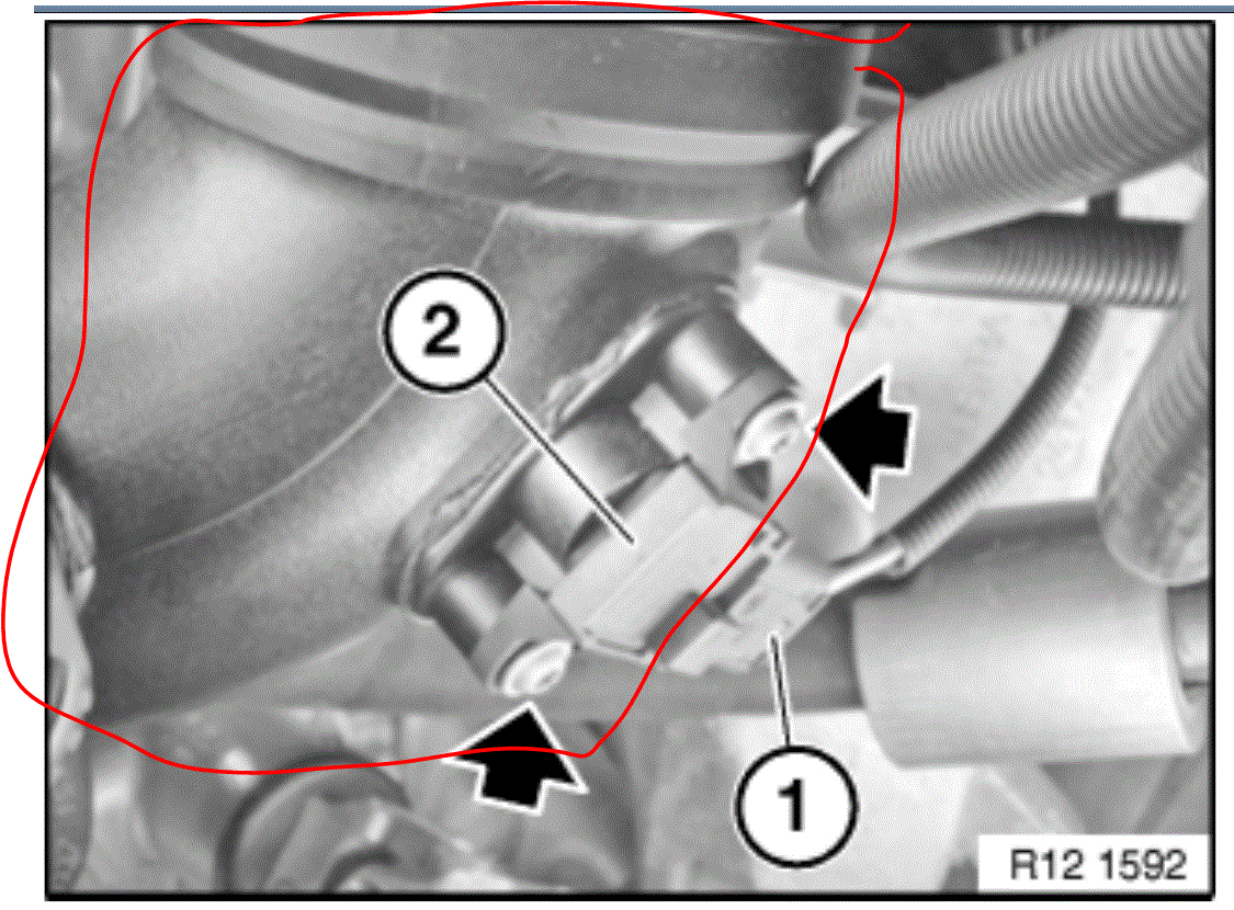

If you have no boost, check the charge air tube, It runs up to the air box. I attached the best pic I have below. They are known to break (crack) which affects the turbo. Also, I don't know what modifications were done, but is the check engine light staying on while the engine is running?

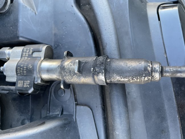

All vacuum lines seem to be fine and the charge air tube is secure with no cracks, I’ve also noticed if I press down the accelerator and keep the RPMs at around 1,500 it isn’t stable it drops down to around 1,000 RPMs then back up and continues to do that.
I was getting misfire on cylinder 5 and pulled the injector and found this, I’ve since replaced that injector but still running lean, maybe all the injectors need replaced?

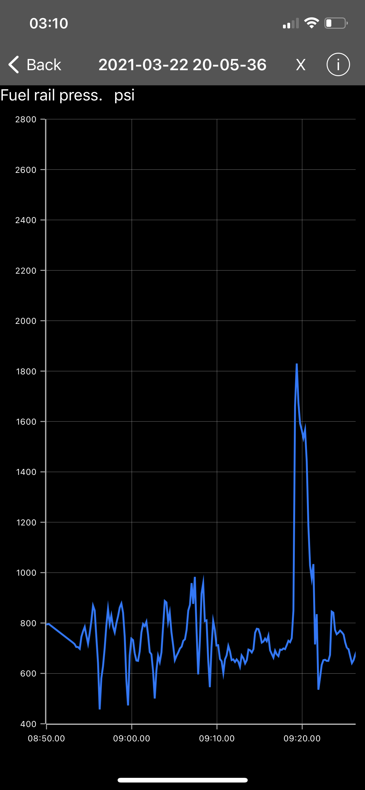

The fuel pressure seems to drop under 600 when driving and hits around 2700 PSI under load.

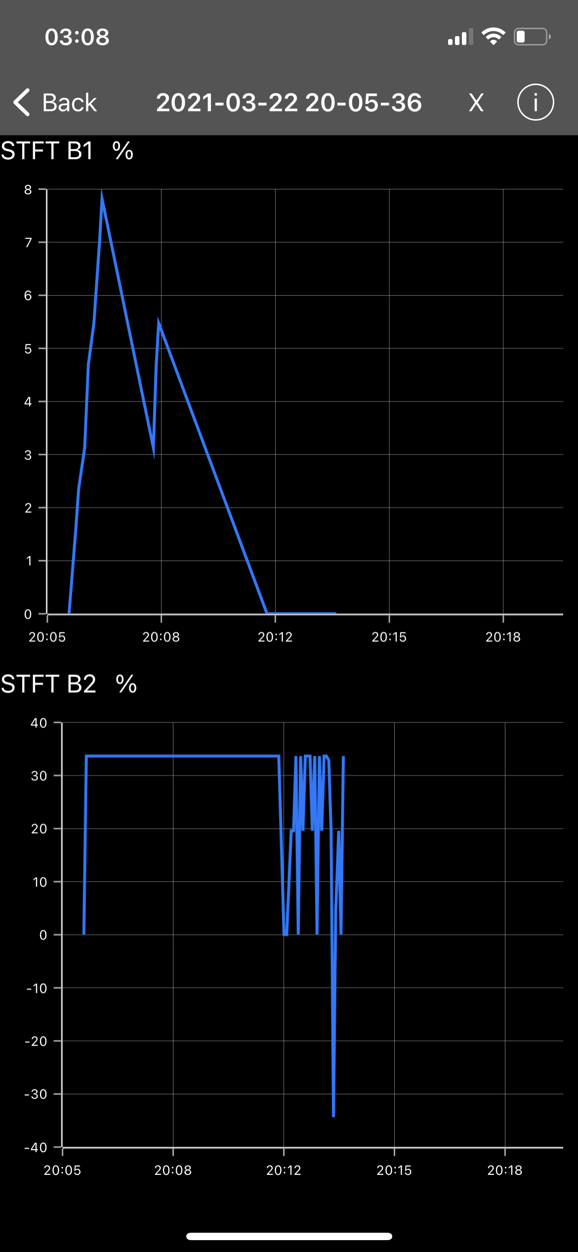

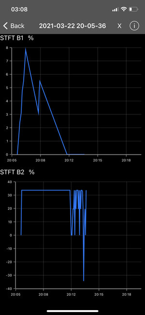

  • 110,194 POSTS
Normal stft should between +10% and --10%. If I'm reading your scanner correctly, bank 2 is running near 35% and then to --35%. Something is causing the computer to add a ton of fuel to that bank. Are you certain there isn't an vacuum leak? Do you still have the upstream o2 sensors? If you do, is there any chance of an exhaust leak before the sensor?

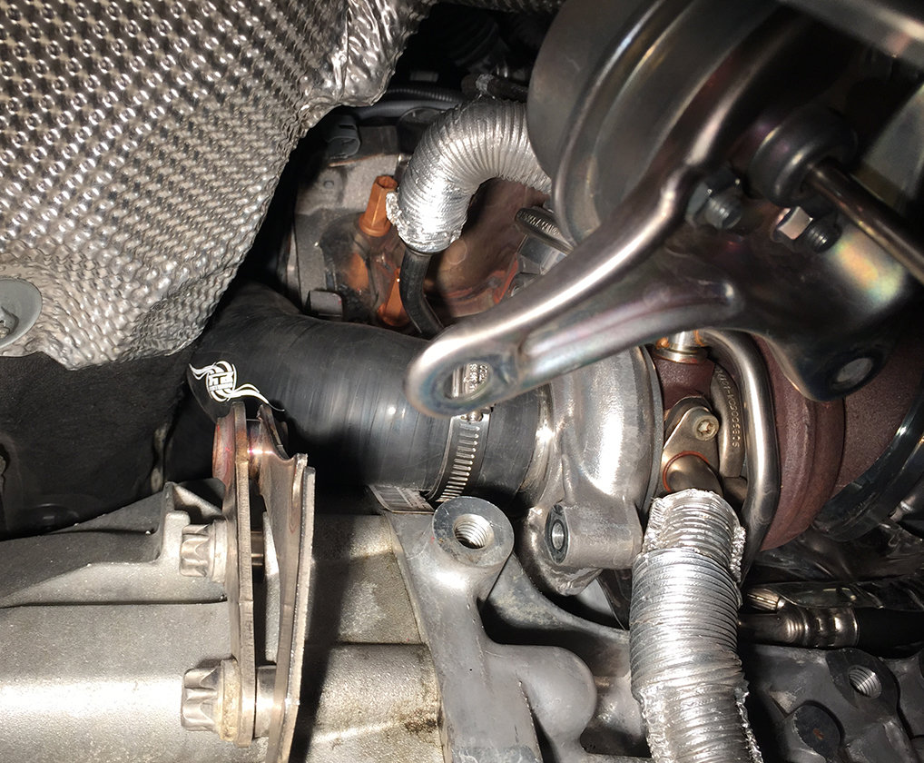

Yes, the upstream o2 sensors are still in. I will jack the car up tomorrow and check over the exhaust for any leaks.
If the rear inlet pipe came loose from the turbo (like in the photo) would that cause all the issues i'm having with no boost and the loud turbo noise?
Thanks
Apr 8, 2021 at 7:33 PM
  • 110,194 POSTS
Yes, that will cause an issue. As far as the exhaust leak, check around the exhaust manifold. If there is a leak pre-cat, unmetered air can get into the system and the upstream sensor can think it's a lean mixture. As a result, the computer tries to compensate by adding fuel. Hence the high STFT readings.
