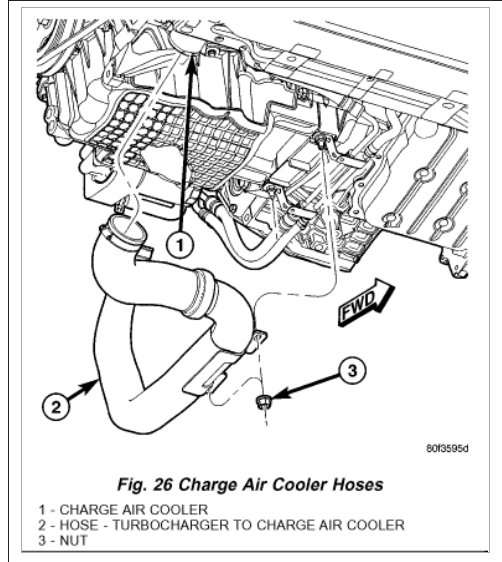

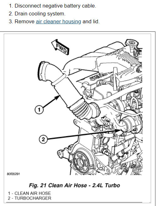

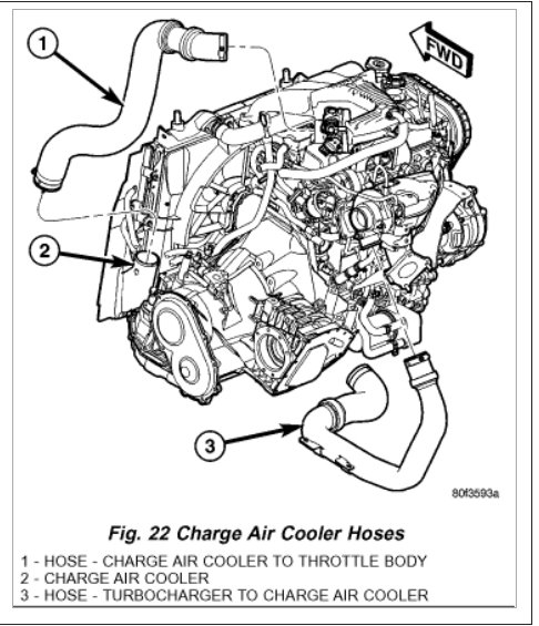

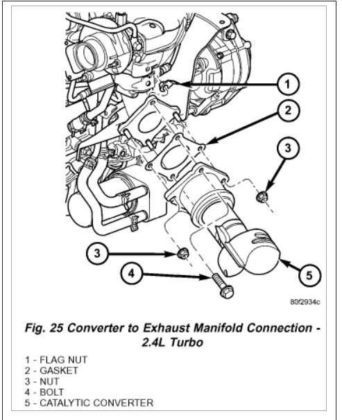

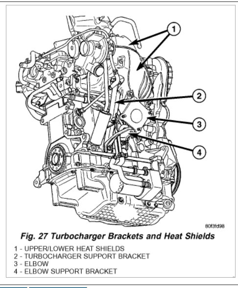

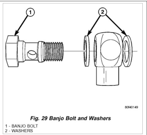

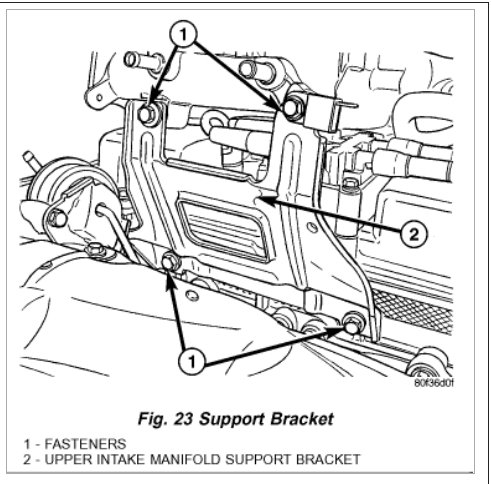

my car runs and made it through a recent inspection. There is a loud whine coming from turbo during acceleration. Is there anything I can do to fix this or do I need to replace the turbo? Is there an affordable option for replacement?
Apr 8, 2018 at 1:24 PM
  • 55,612 POSTS
Yes, this is a sign the turbo has gone out check eBay for a replacement.
Here is how the turbo works:
https://www.2carpros.com/articles/how-turbo-chargers-work
Here is how you replace it. Check out the diagrams (below).
