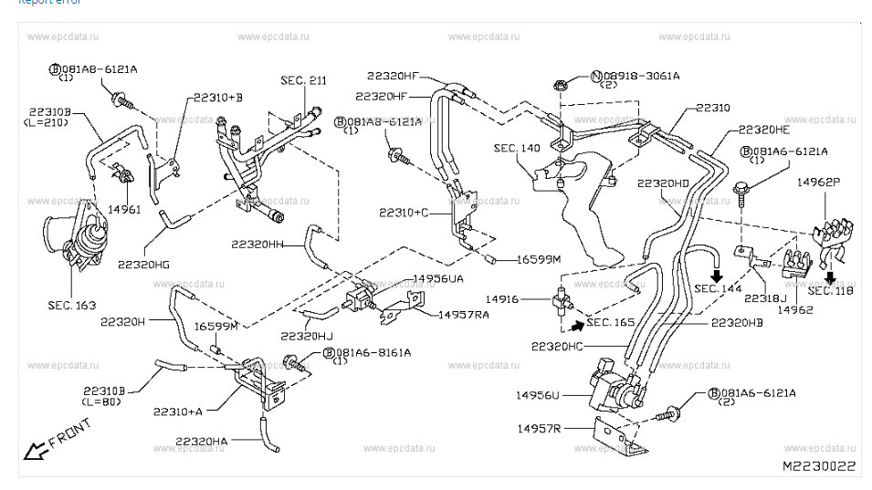

I have the vehicle listed above V9X. Turbo vacuum boost.
Apr 4, 2023 at 9:45 PM
Experienced Mechanic
55,721 POSTS

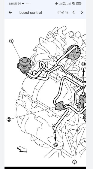

Here are the vacuum line diagrams to help connect the turbo and wastegate. Check out the images (below). Please let us know what you find.

Diagram 2, that's the one, the connections are just okay on the side shown remaining the other side which is missing.
