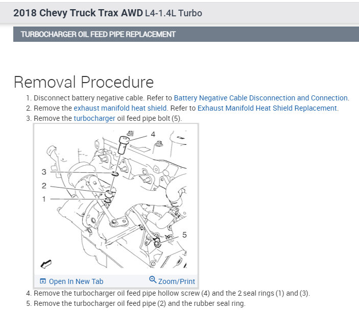

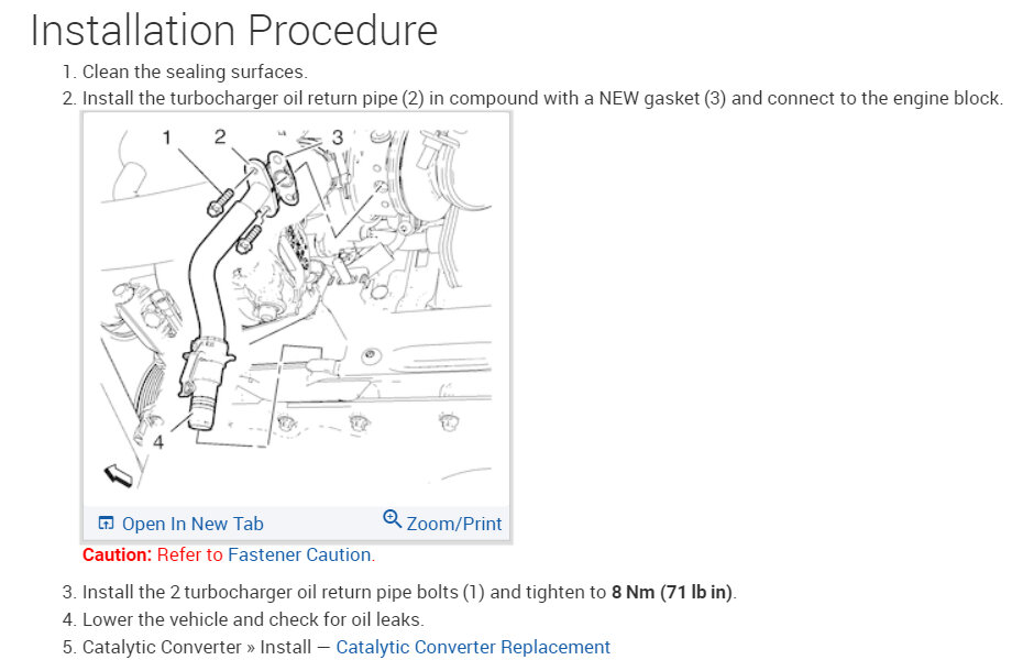

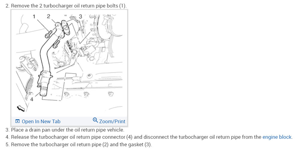

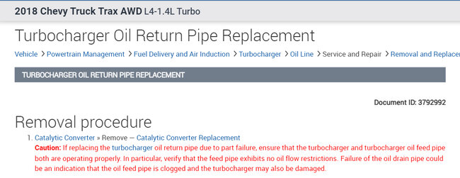

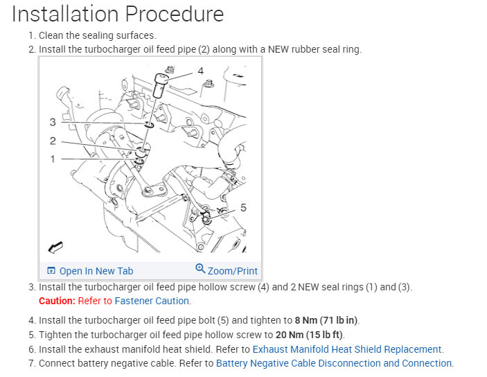

Hello, I understand that these oil lube lines should be changed periodically, I do all my own oil changes and figure I could do this myself too, or is this not advised? I have worked on all my vehicles (up to a certain point,) but this will be a new experience for me.
Jan 26, 2023 at 10:41 AM
  • 110,246 POSTS
As far as replacement, I've attached the directions specific to the feed line and return line below. I would inspect the ones presently on it for any evidence of wear or if there is a leak where they are bolted to the components.
Let me know if this helps. Also, let me know if you have questions.
