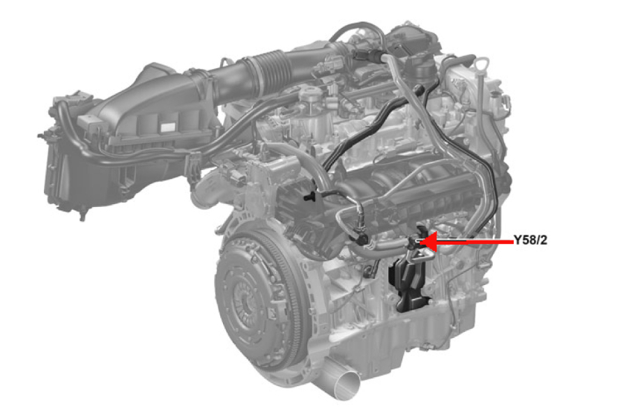

as for the oil, , take my info with a grain of salt because I am no engineer I am just going off my experience but you will find oil in any intake of any engine, because all of the vapors from the crankcase will eventually condense and build up. You just have easier access to seeing it in the turbo pipes. Usually its "after" the crankcase lines , meaning oil is not present BEFORE the lines where they attach to the intake stream but AFTER. So its normal to an extent to find oil in the intake tract on turbo cars, yes there is a point to were its an issue which can usually be tied back to the crankcase venting system. on your engine you have that big ol Spiderman looking line setup and tank that bolts under the thermostat on the back of the engine (if memory serves) so you'll need to replace that whole setup and yes I suggest from Mercedes dealer. It will be priceir than online and such but as long as you get an oem Mercedes part it will work and last. They were all updated on almost every engine., it was a bad design with lots of issues and updates. Let me know if any of this helps. Thank you sir. Lou
photo attached that shows the pcv solenoid and the line assembly.
