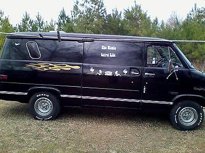

Yes, I have a question and am wondering if you may know what the problem is. I have a 1978 Chevy G20 with a 350 engine, 5.7 Liter, 3/4 Ton, 8 Cylinder Van with a Turbo Hydramatic 350 Transmission. Okay, my transmission will not go forward, but works just fine in reverse. The last time I drove the vehicle was in October / November 2014 and when I drove it then it shifted perfectly without any problems. Meaning it has sat not being drove for roughly 4 months as it is now March 2015. I checked the Transmission fluid from the dipstick it was full, translucent red, and contained no metal fragments. I always make sure to check my fluid in it every time before I go out in it and it has always been at the full line. Also, when I say that it won't go forward. I mean that it doesn't engage in any of the drive ranges such as (D), (L1), or (L2), but Park, Neutral, and Reverse all work fine. The only leak I have seen is a very small leak is around the speedometer cable. Where it leaks from the speedometer cable is also translucent red transmission fluid.

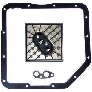

Through the research I have done I am leaning in the direction of changing the filter / looking at the valve body. I am wondering if the Filter can get so clogged that it wouldn't allow the fluid and or air pressure to reach the forward clutches and not allow them to go forward? I was looking at the Big Box Automotive Parts Retailers and the Transmission Filter that fits this product according to their description is supposed to be a nylon screen rather than an actual traditional transmission filter. Would that make it more prone to be clogged?

changing the filter but you might as well drain it anyway and check the filter and then pull it out, that transmission in that van comes out in 15 minutes easy access from the inside doghouse. the reversed year always works on a different clutch back so you may burn up the forward clutches and the reverse will still work. Or vice versa you can burn up the reverse in the forward clutches will still work just no reverse. Try this first without starting the van check the oil level where it is at on the dipstick, then start the van and check it again and see if the oil has gone down, that I will tell you if the front pump of the transmission is still working. but it sounds like it's going to have to come out. These guides can help
