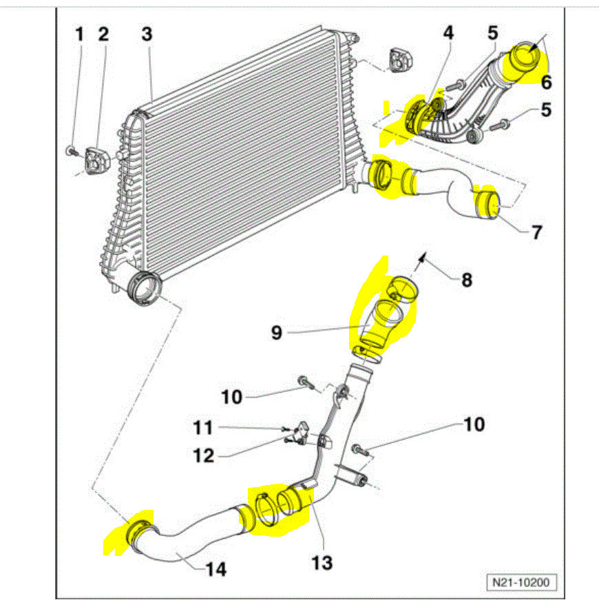

Took my 2013 EOS Komfort car to VW for 60,000 service. The MIL (Service Engine) light was on, and they replaced the Turbo Bypass Valve. 3 weeks later light comes on. Went to AutoZone and it threw a PO299 Turbo/Super Charger Under-boost. Computer recommended a Turbocharger Boost Solenoid. Is this a separate part? If it is, should this have been discovered the first time. The Auto Zone guy said it seems early in the mileage (60,000) to have that issue.

The idea that you just had work done to it leads me to believe something is not attached properly and causing a pressure leak at the charge air system. That is the first thing I would check.
I attached a pic below of the charge air cooling system. I highlighted all the points that should be checked. Also, make sure none of the hoses were damaged or broken.
Let me know what you find.
-1
Saturday, July 18th, 2020 AT 4:46 PM
SGABC
I checked what I could without a lift. There isn't much access so I could just feel the hose connections and wiggle the hoses to make sure they were attached. I had even less access on the side where hose 14 attaches. That's the side where the battery is mounted. Also, obviously there could be a pinhole in a hose that I wouldn't know about. Complicating matters is my car is parked outside where it's in the high 90's everyday so everything stays hot!

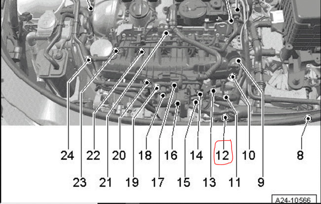

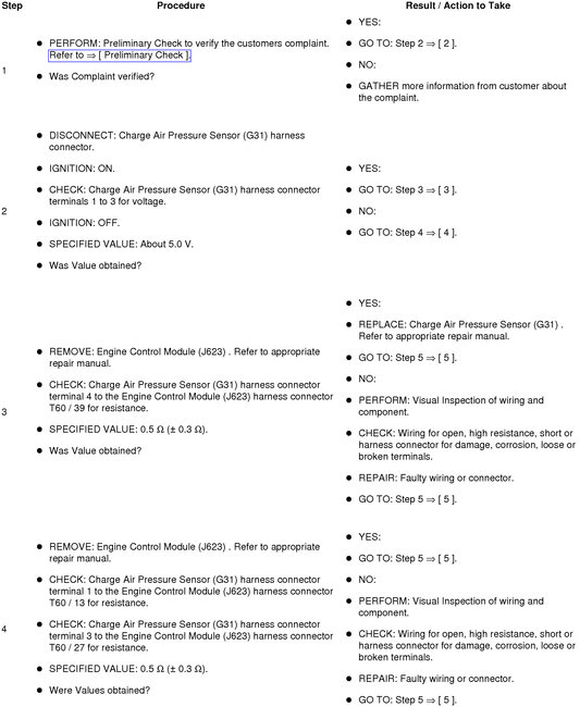

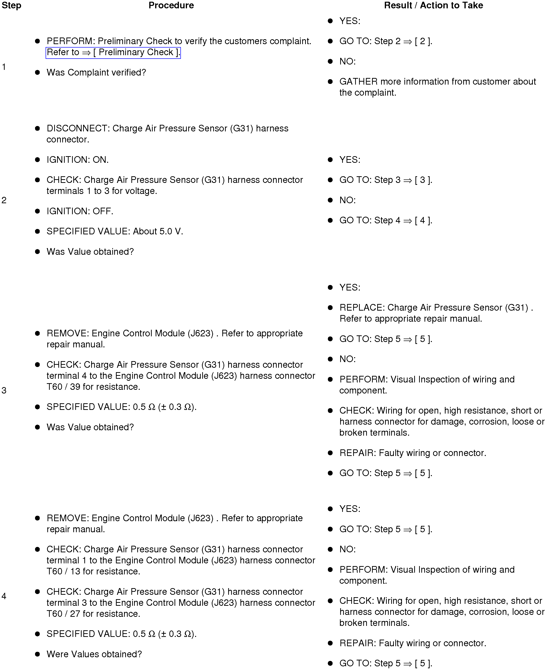

If there are no leaks, the only other that I believe could set this code is a pressure sensor. The charge air pressure sensor can be tested. I will provide the directions and steps. If you feel comfortable doing it, great. If not, let me know.

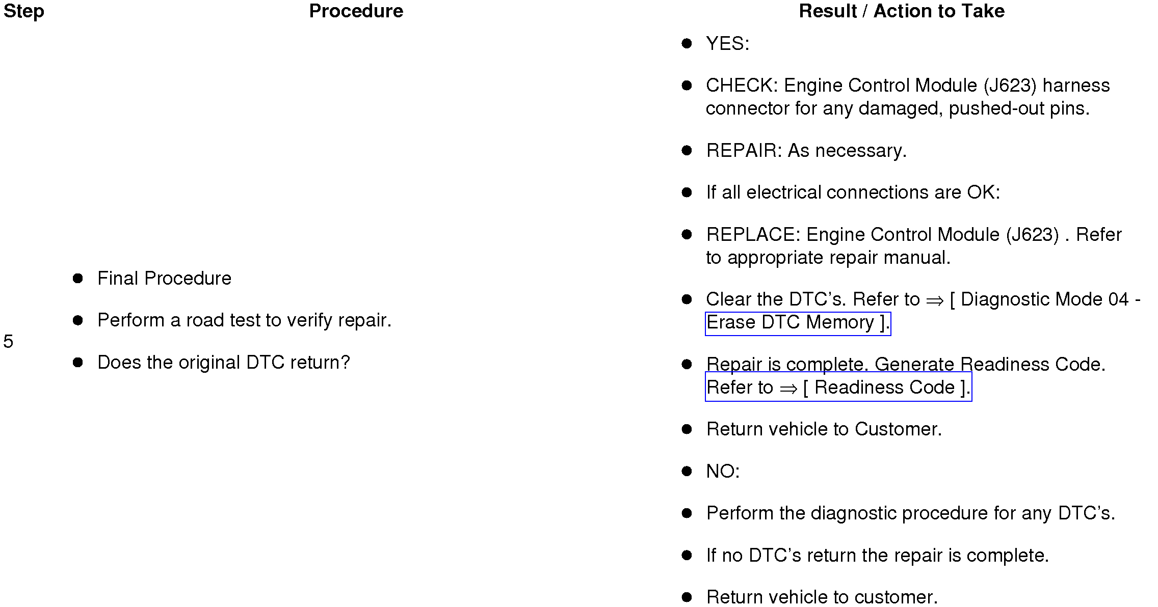

Test Procedure
see pic 1
see pic 2

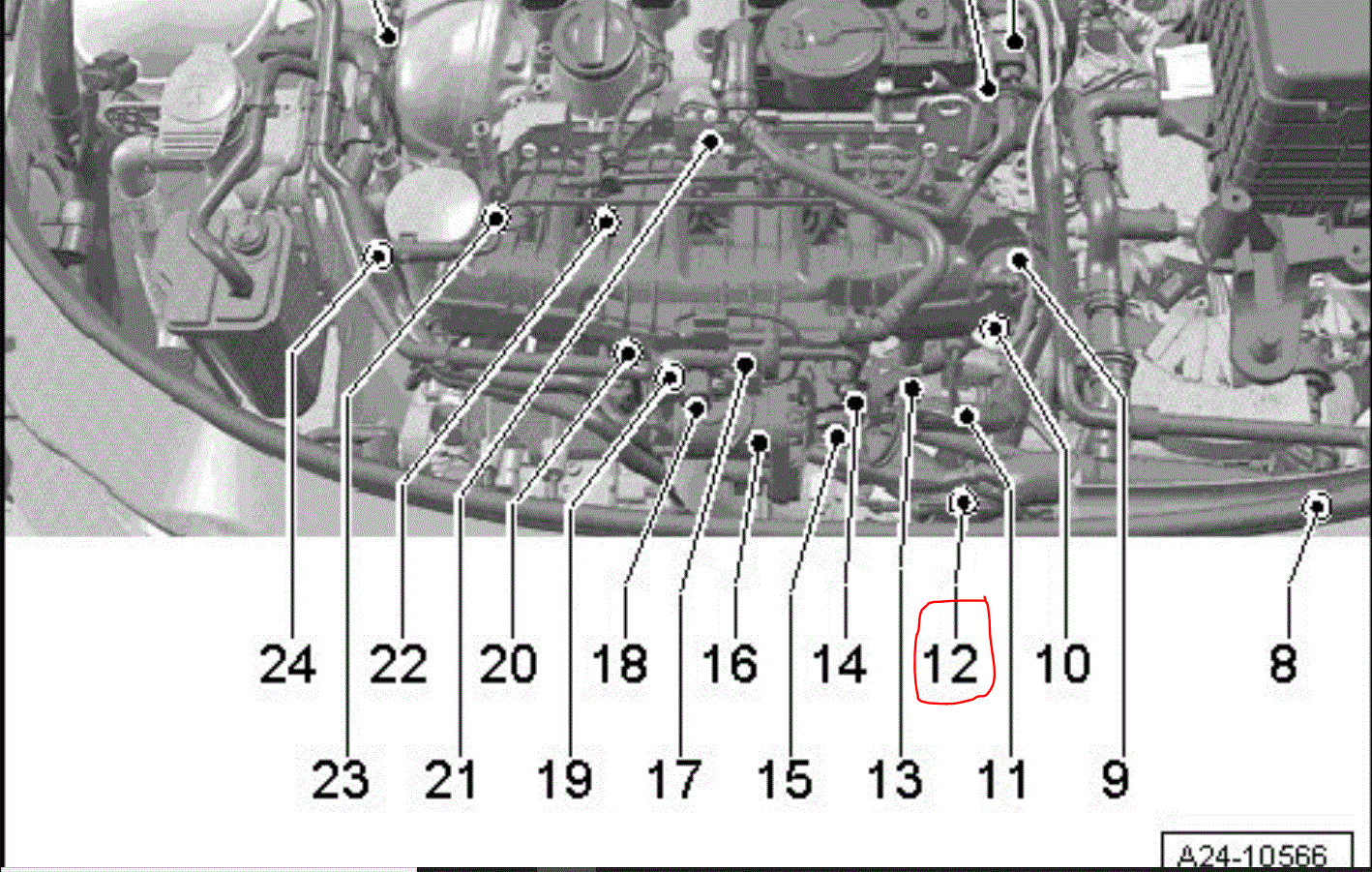

See pic 3 for charge air pressure sensor location.
