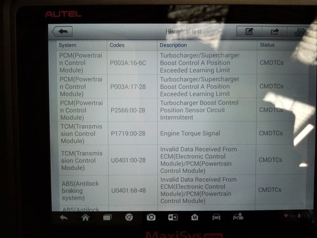

To be honest I am not keep on spending £900 on a car that is valued £1200 !!
So I really want to know if it is the turbo and not something else because looking at the service of the car it has had the turbo actuator with sensor been replaced. It could be this and can possibly save me a huge amount !
This may be helpful:
These signs come up in my car ('Engine Malfunction' and 'Transmission Service' and the Traction control sign) and the car would feel heavy and would not be able to accelerate whatsoever.
I have to stop and turn the car off and turn it back on, to find all the signs gone.
Are these things related to a turbo ?
Many thanks again. And I will try my best to get that tag on my turbo.

Okay, can you give me the codes that are set in the system?
Did you verify the hose to the turbo and the charge air cooler are tight and there are no leaks?

Well, I didn't do the test on the car. I took it to a garage and he told me it's the turbo.
So not sure if he has checked the hose to the turbo and the other stuff.
I did ask him for the code that said it was the turbo and he allowed me to take a pic (this is attached to the reply)..

The codes do indicate the turbo could be the issue.
what diagnostics did they do to confirm it? Just because it set codes does not mean it is the turbo.

Yeah.. all he said that it was the turbo and it will cost $900.00 ish!
Jul 10, 2020 at 1:20 AM
I would get a second opinion. It sounds like he is guessing.
You could also tell him that if you give him the okay to do it, you will not pay for the repair if it does not fix it.
