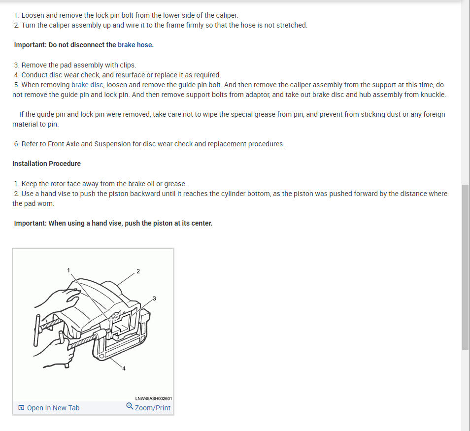

How tough is it to do the brakes?

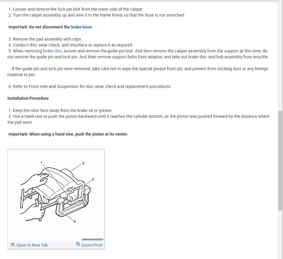

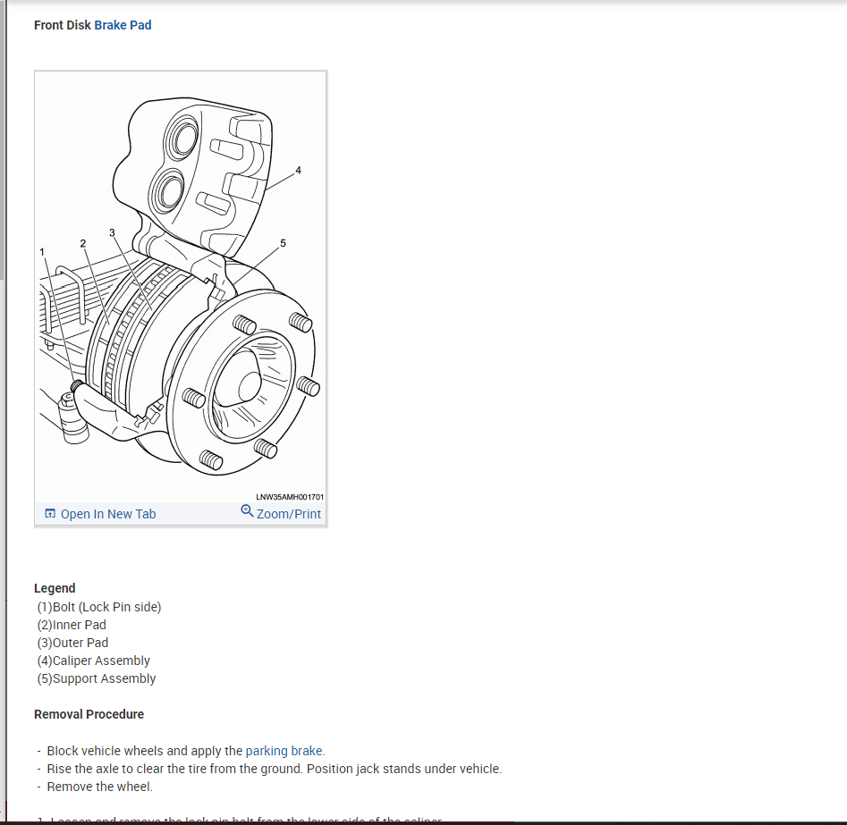

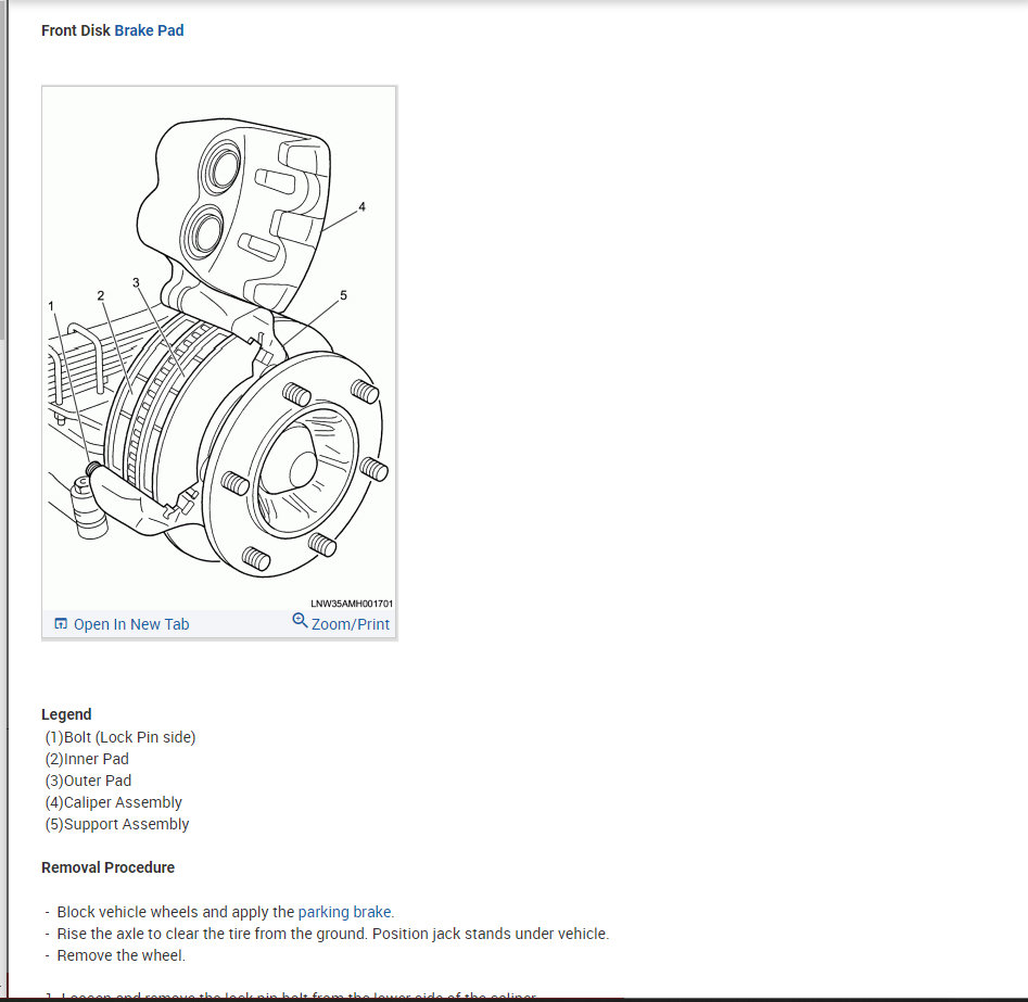

Here are a couple guides that will help with step by step instructions. Also, there is a video on a similar vehicle that will help with details on replacing these on your vehicle.
https://www.youtube.com/watch?v=78rDqpK0CuM
Below is the process from the manual that will give additional details that you will need. Please let us know if you have other questions. Thanks
