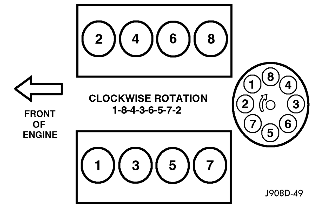

Just did a tuneup on my vehicle listed above (plugs, wires, cap and rotor) and now it won’t start at all. I have spark and am getting gas. Any ideas? Would the plug wires being wrong on the distributor cause this?

Good morning,
I attached the diagram of the cylinder location and the firing order for you. Please verify you have the wires attached correctly.
