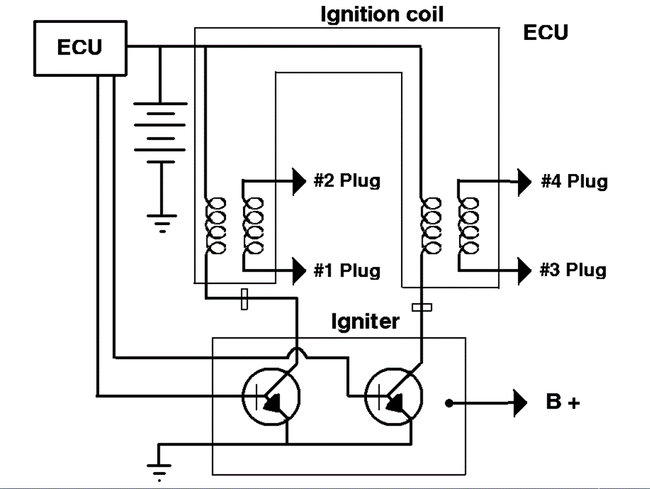

Does my engine have a cap and rotor?
1994 SUBARU LEGACY
220,000 MILES • 2.2L • 4 CYL • 4WD • MANUAL
DARLENE ARMENTA
I am buying parts for my car. Does it have a cap and rotor? I can't find one.
Jun 24, 2021 at 6:43 AM
  • 110,244 POSTS
In 1994, the 2.2L did not have a distributor cap and rotor. This vehicle uses an ECM-controlled electronic direct ignition system. You have two coils, a camshaft position sensor, a crankshaft position sensor, and an ignitor. These components are controlled by the ECM to control ignition and are in place of a cap and rotor.
I attached a pic below showing the system. Let me know if this helps.
