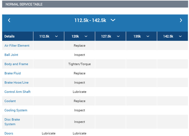

I need routine maintenance engine tune up specifications.
Jan 26, 2019 at 5:57 PM
SCGRANTURISMO
  • 4,897 POSTS

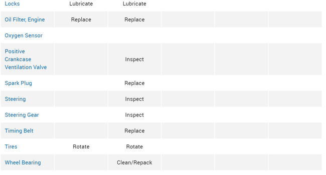

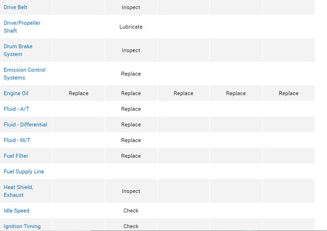

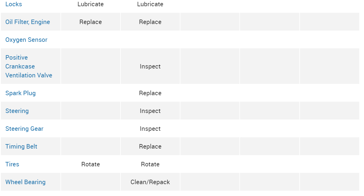

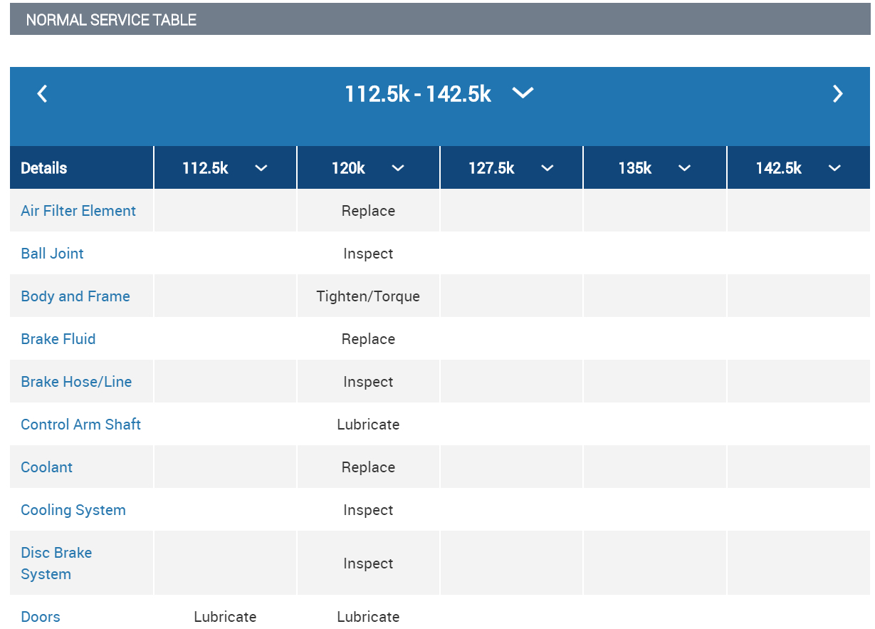

Hi DB Cooper123, my name is Alex and I will be helping you. My maintenance schedules only go up to 150,000 miles so I copied down the 120,000 mile schedule for you. It is closest to your mileage if doubled. The important one is to change your engine oil every 7,500 miles. Thanks.
