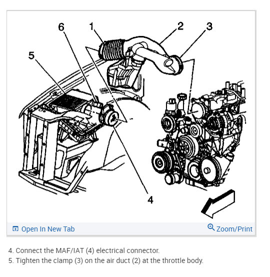

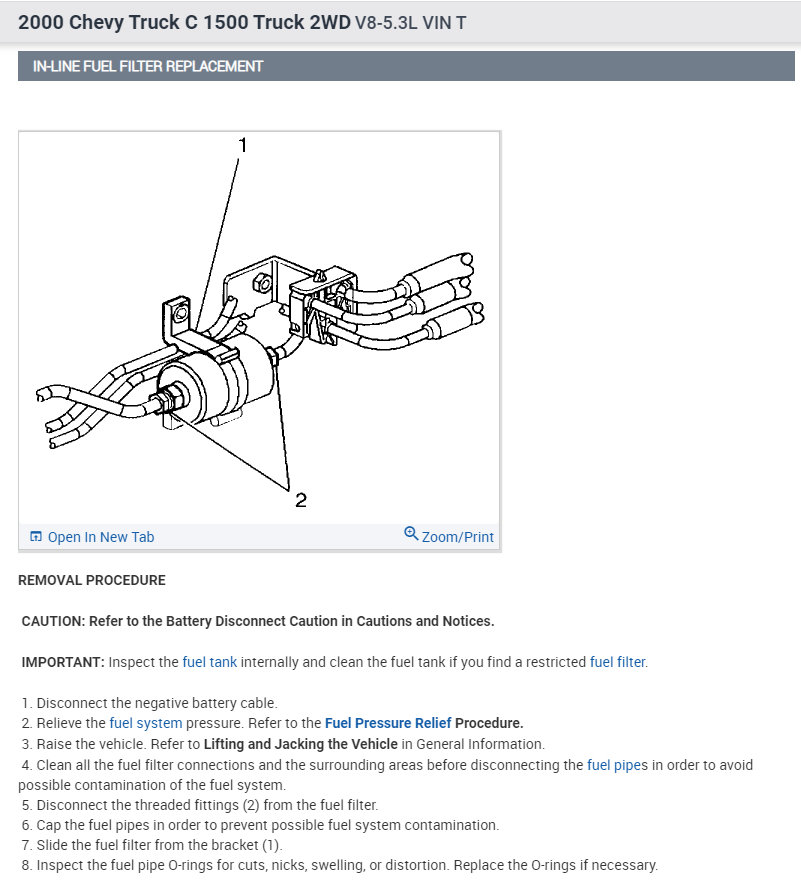

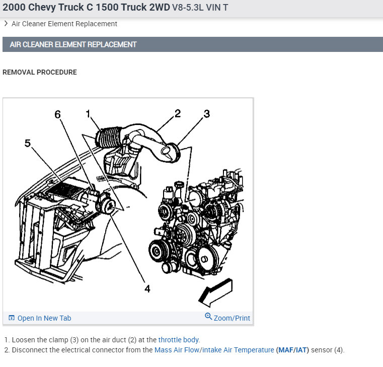

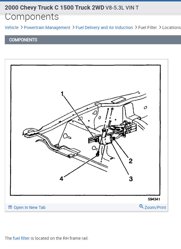

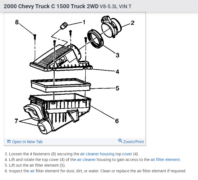

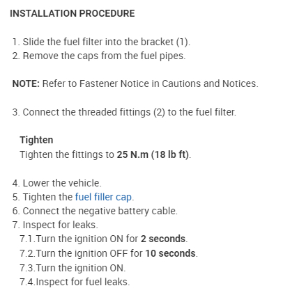

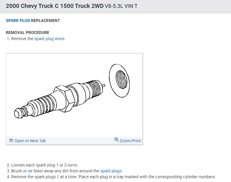

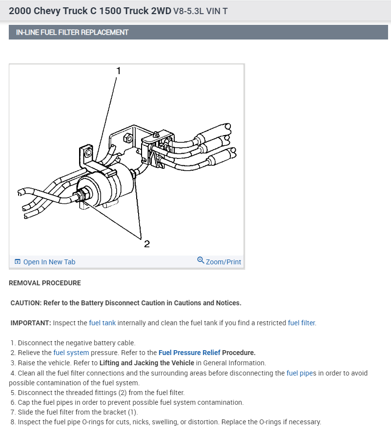

engine is rough on acceleration. Idles fine but especially on hard acceleration it hesitates a lot. I had a mechanic do a tune up and replace belts and hoses at 100,000 miles and just did the hoses and belts again. Thanks much.
Jun 14, 2022 at 6:01 AM
SQM
  • 6,383 POSTS

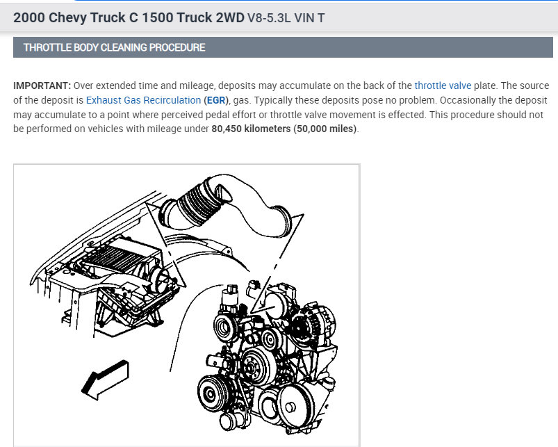

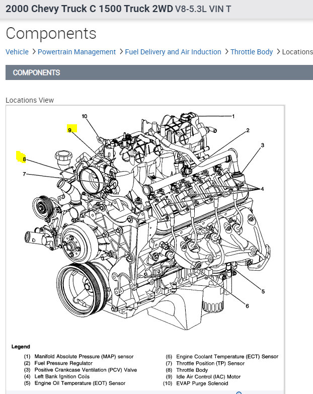

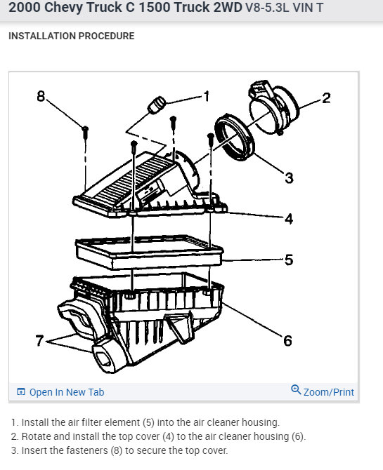

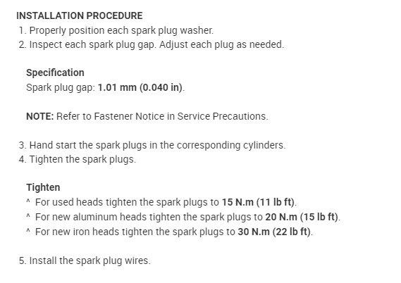

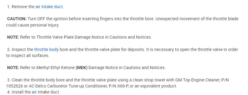

Typically, on a tune up you will have to change the spark plugs, wires, air filter, fuel filter. Clean out the throttle body, idle air control motor also clean the mass air flow sensor.
Take a look at this helpful guide:
https://www.2carpros.com/articles/how-to-tune-up-a-car-engine
I have attached some diagrams below for your reference.
Let me know of any questions.
