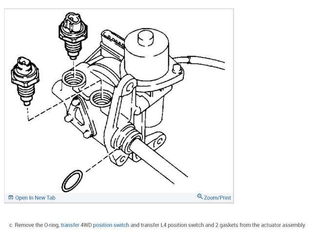

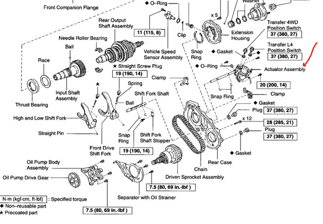

Yep, I would start by replacing the transferase shift actuator because you may have got a defective unit which is common with inexpensive parts. Here is how the job is done, if this doesn't help the transfer case is worn out and needs to be rebuilt. Check out the images (below). Please let us know what happens. I can send you rebuild instructions as well.

Just as an update, I opened the transfer case actuator. Apparently it may have been a cheap defective unit, because it was jammed up inside, and it looked like some of the electrical connections had some kind of glue on them that was preventing contact. I fixed the metal that was jamming (by bending it so it didn't jam) and sanded the contacts down to bare metal. Everything works now. Yay! I'm grateful and blessed.
